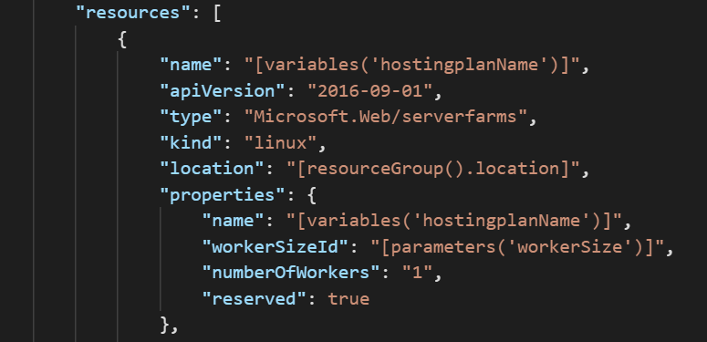

    • TOMCAT|8.5-jre8 is a valid LinuxFxVersion for Linux app service. If you want to deploy your application on Linux app service plan, then you need to add another property reserved: true under resource block of app service plan (Microsoft.web/serverfarms). Also, you can refer to this sample arm template to deploy .NET app on Linux app service plan.

    Make sure, your App Service plan is Linux, not Windows. If it is Windows, change your app service plan to Linux.
