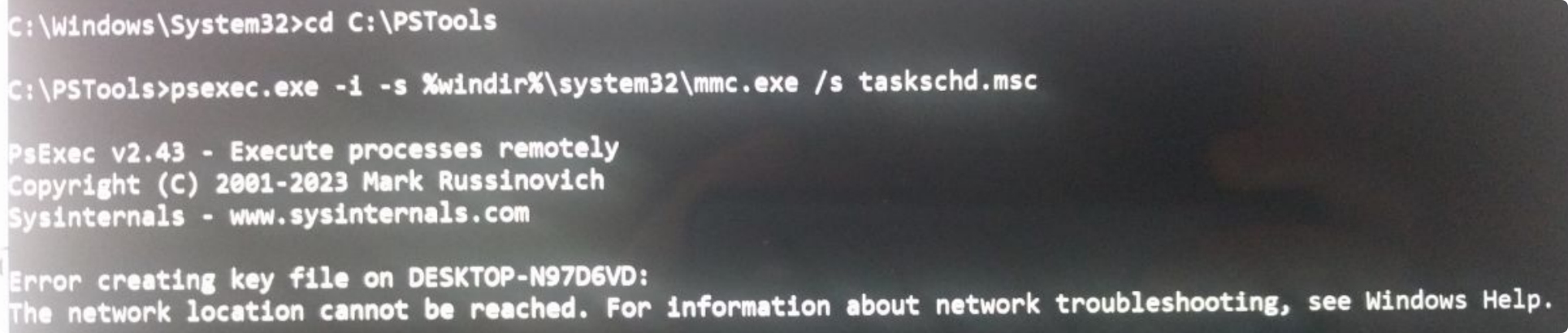

I have a win11 computer with no access to the internet.
cmd is run as administrator.
After trying to open a task scheduler via the PSTools on my desktop (psexec.exe -i -s %windir%\system32\mmc.exe /s taskschd.msc) I am getting the following error:
Error creating key file on DESKTOP-12345:
The network location cannot be reached. For information about network troubleshooting, see Windows Help.
iShot_2024-05-08_06.46.29
Is there any way to fix this?

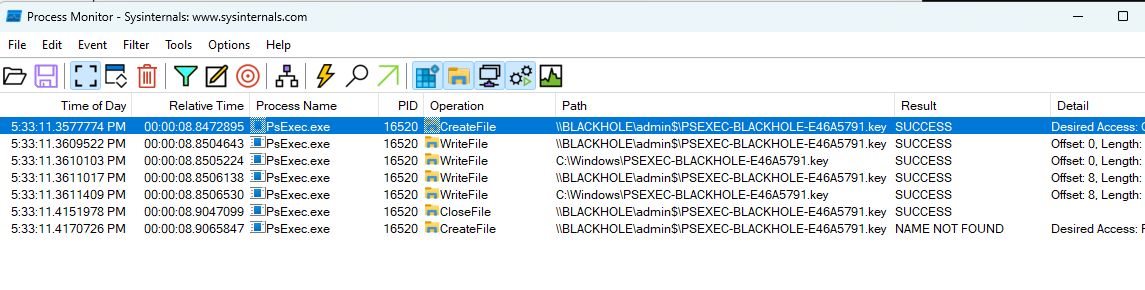

    That worked on my laptop, even with wifi turned off. So I traced it with Process Monitor. I see it using the Admin$ share, presumably because it is designed to work on another pc. The help output says, "PsExec executes a program on a remote system". So it would appear that whatever network configuration you have, does not implement an Admin$ share.
    Why do you need to run the task scheduler as the system account?
    Create a scheduled task, that runs as the system account, and use the command line schtasks.exe or a Powershell script to do whatever you need to do.
