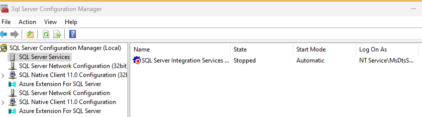

    If you have the Database Engine installed, I think it is because you selected it during install. Or it was there already.
    I made the selection you did: Integration Services + Scale Out Master. This is what I see in SSCM:
    This is what I see in the Services applet:
