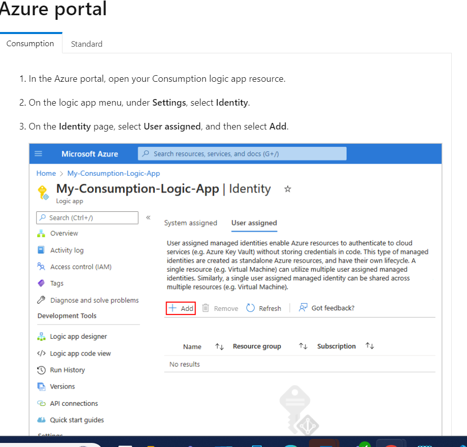

    Yes support is there , please check this https://learn.microsoft.com/en-us/azure/logic-apps/authenticate-with-managed-identity?tabs=consumption
    Using Managed Identity to access the storage account from a Logic App Standard running in an App Service Environment (ASE). Managed Identity allows Azure services to authenticate securely without needing explicit credentials like connection strings.
    Here are a few things to consider and troubleshoot:

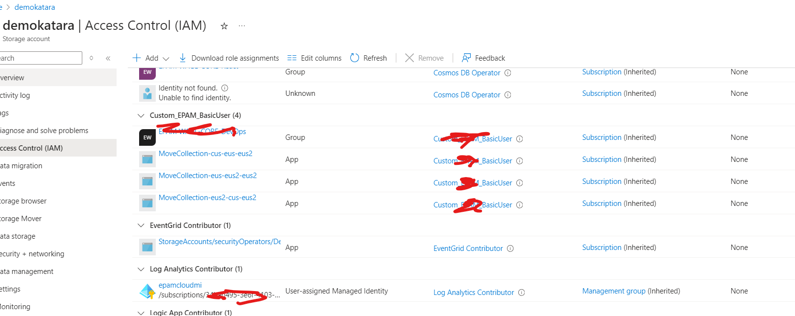

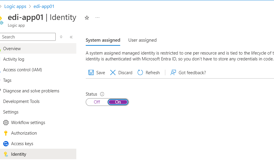

    1. Managed Identity Setup: Ensure that Managed Identity is properly configured for the Logic App Standard instance within the App Service Environment. You can check this in the Azure portal by navigating to the Logic App's settings and then the Identity section. User's image
    2. Access Control: Confirm that the Managed Identity has the necessary permissions (e.g., Blob Data Contributor) on the storage account. You can set this up in the Access Control (IAM) section of the storage account.
