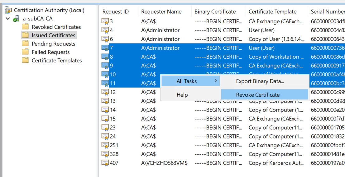

I try to find out the following:
  1. Is there any API that I can use with AD-CS? If so, where can I find it's documentation?
  2. If there is no API, how can I revoke a certificate?

    ADCS is a COM server, so it is accessible only via DCOM RPC calls. In other words, there is no HTTP web service to manage CA. If you can use DCOM, then you can use ICertAdmin::RevokeCertificate COM interface to automate certificate revocation.
    There are other alternatives, such as:
