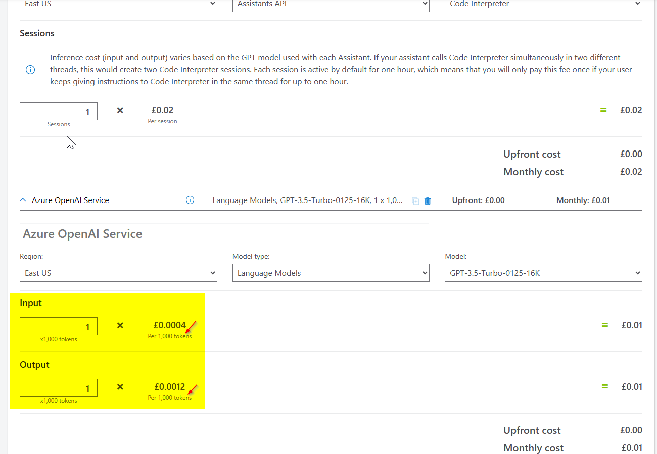

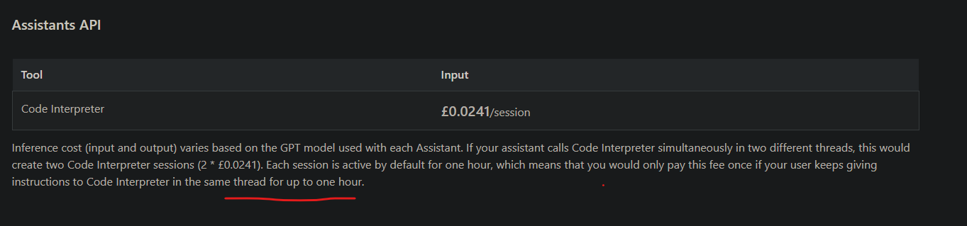

Hi I am using gpt-35-turbo-0613 model for Assistants api (same thread) as code-interpreter I have 83 input token and 198 output token and my calculated price is £0.0304445(which appears high) including code-interpreter source the problem is I quite does not understand the way code interpreted price is calculated is it hourly based. My use case only need to hit the api once for few minutes do I need to calculate price based on minutes of use or the minimum threshold is 60 minutes or I need to pay £0.03 no matter I use it for 60 minutes or 5 minutes ? what should be my estimated cost for above mentioned tokens, model and 5 min time/session on same thread.

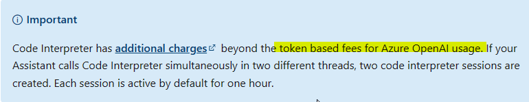

    @Karishma Nanda Any input/output tokens will be charged additionally apart from inference cost for assistant.
    Ref: https://learn.microsoft.com/en-us/azure/ai-services/openai/how-to/code-interpreter?tabs=python

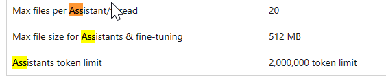

    For files, Assistants use the same API for file upload as fine-tuning. So, the limits for files are applicable. I don't think there is a charge to store the files, similar to fine tuning files. I hope this helps!!
