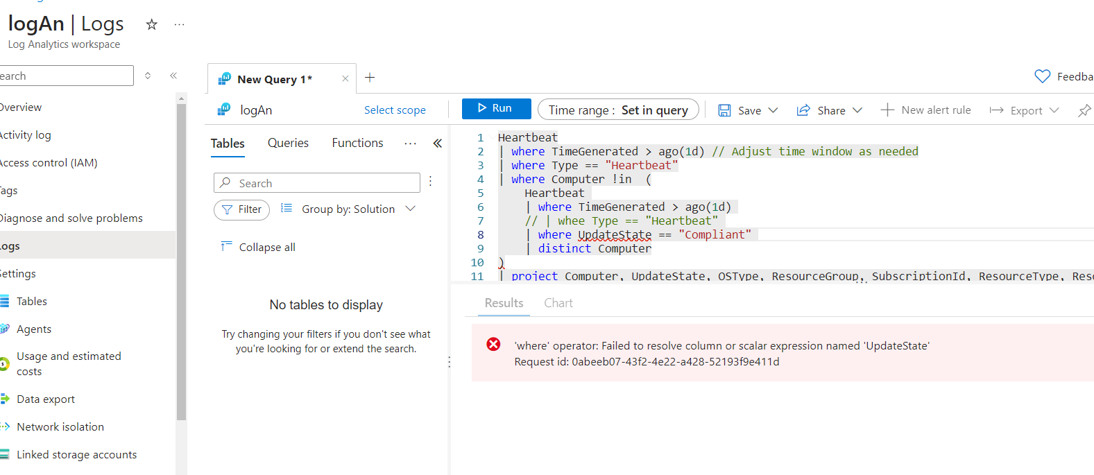

    Use Log Analytics queries to identify VMs that are not included in the maintenance configuration managed by Azure Update Manager. You will need to create Log Analytics queries which should search for VMs that haven't reported recent update compliance status or are explicitly excluded from update deployments.
    You can use the following Kusto Query Language (KQL) query to identify VMs that haven’t reported recent update compliance status or are explicitly excluded:
    Heartbeat
    | where TimeGenerated > ago(1d) // Adjust time window as needed
    | where Type == "Heartbeat"
    | where Computer notin (
        Heartbeat
        | where UpdateState == "Compliant"
        | distinct Computer
    | project Computer, UpdateState, OSType, ResourceGroup, SubscriptionId, ResourceType, ResourceName, ResourceId

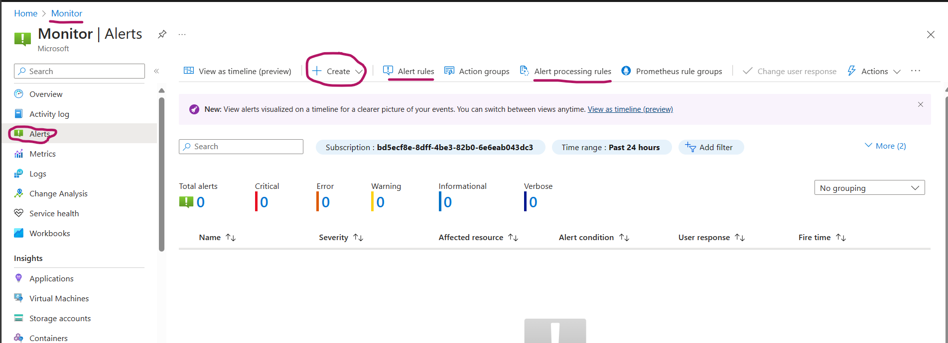

    Once the query to identify non-compliant VMs is established, create alert rules within Azure Monitor based on these queries. These rules will trigger alerts when VMs are found to be missing from the update configuration.
    Specify the criteria for triggering alerts, such as the number of consecutive times a VM is identified as non-compliant or the severity level of the compliance issue.
    Finally
    At this stage, you will have to integrate notification systems by configuring the alert rules to integrate with notification systems such as email, SMS, or Azure Monitor Action Groups. This ensures that administrators are promptly notified when VMs are found to be missing from the update configuration.
