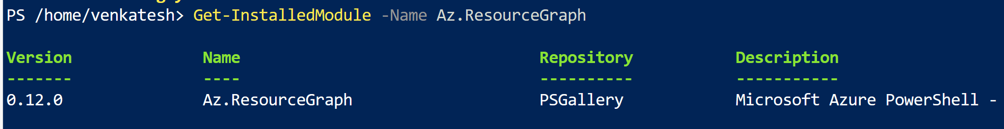

    @Varma Thanks for your patience and time over the call.

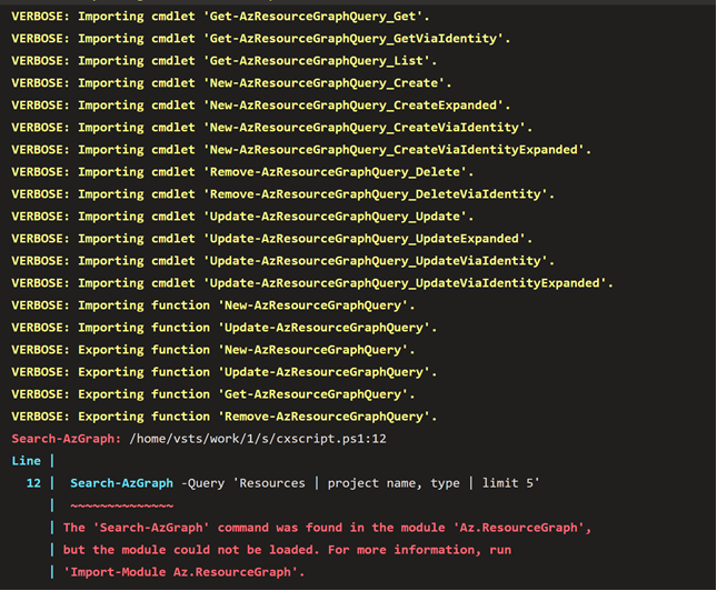

    I attempted to run the shared script in my environment through the release pipeline. Despite making several changes and attempts, I was only able to install the latest module (v0.13.1) and list the commands of the Az.ResourceGraph module. However, I was unable to find the Search-AzGraph cmdlet from the listed cmdlets, and the pipeline failed with the following error.
    A screen shot of a computerDescription automatically generated
    Based on the error message it seems like an issue with azure devops pipeline end. As Azure Devops is not supported in Microsoft Q&A forum. I would suggest you try raise/report your problem in the devops forum here.

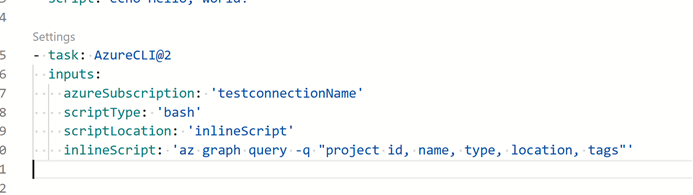

    Alternatively, to achieve your requirement running the resource graph query from the pipeline you can use the AzureCLI@2
    Task and select the script as bash as shown below.
     A screenshot of a computer programDescription automatically generated
    Note: Please modify you query, script and refer to this samples mentioned here in this document on how to run graph queries using az graph cmdlet.
