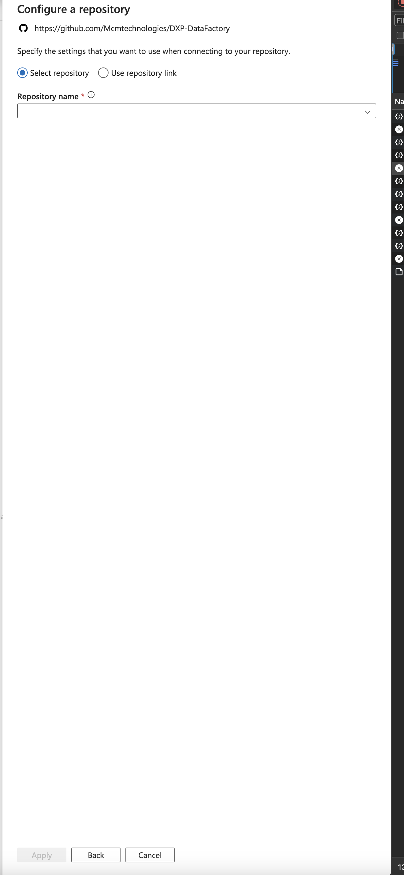

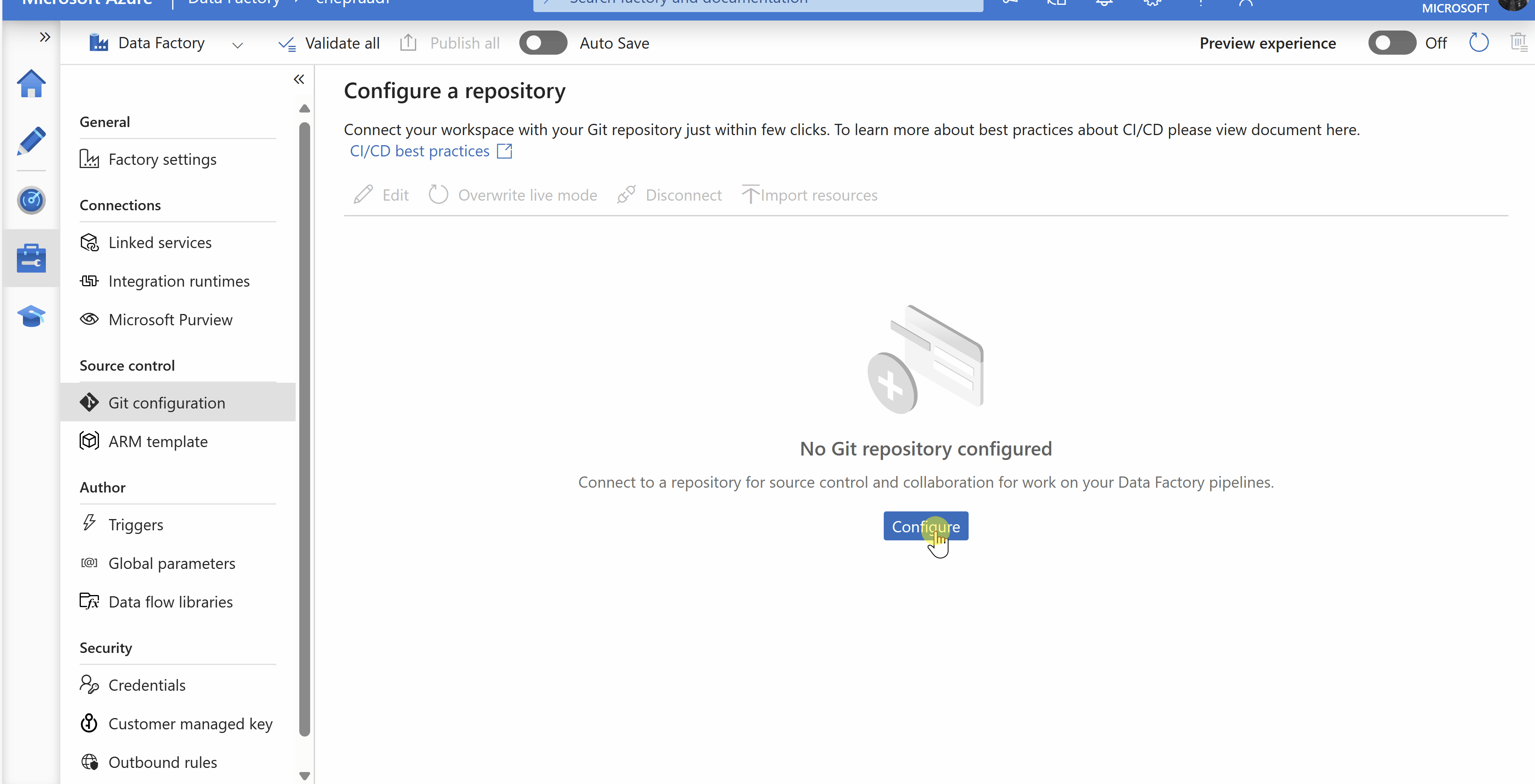

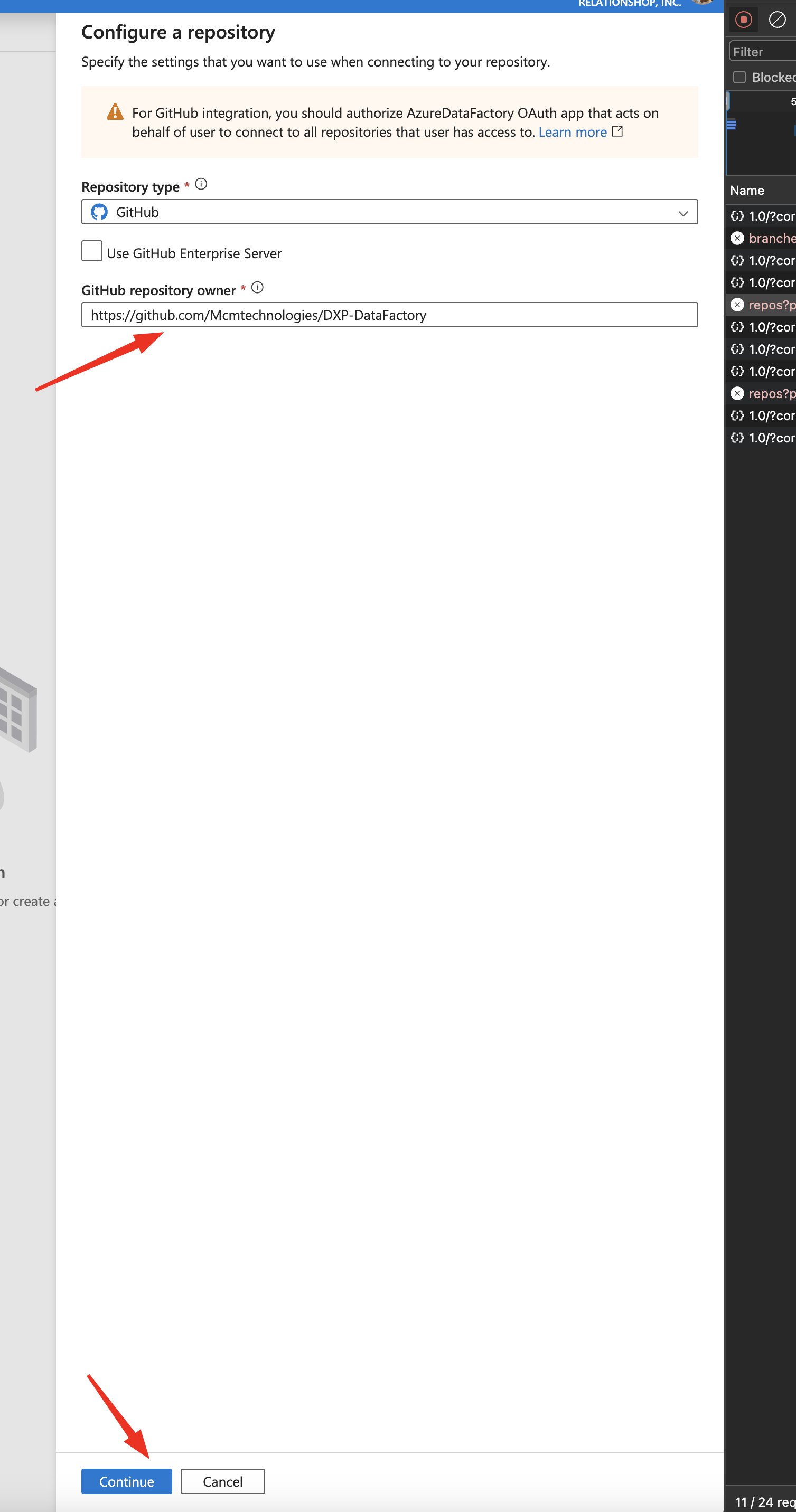

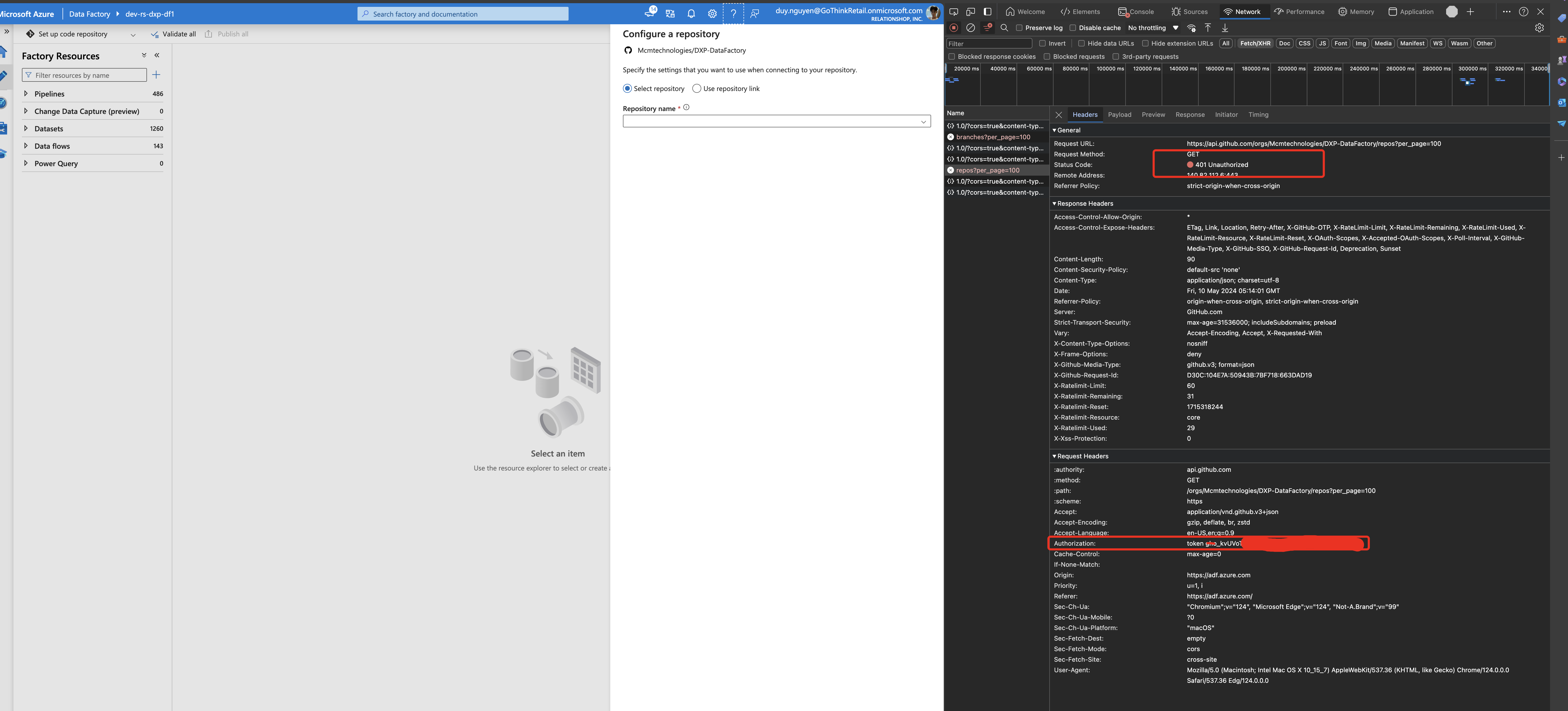

I have error when I try setup repo git integration with new credential it's not working. check in tab network it return 401 but I don't see any step input credential or token???? why it have token in here?? where it come from??

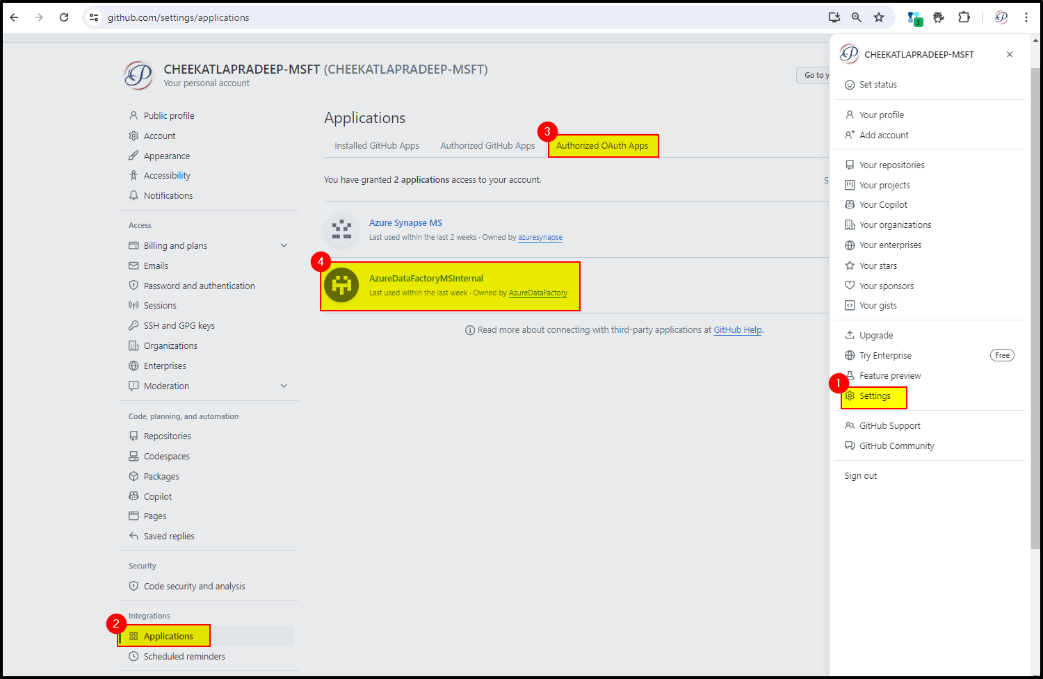

    If you already connected to public GitHub or GitHub Enterprise Cloud and only granted permission to access a personal account, follow the below steps to grant permissions to an organization.
    Once you are able complete the authorization, you will be able to connect to Github from Azure Data Factory studio.

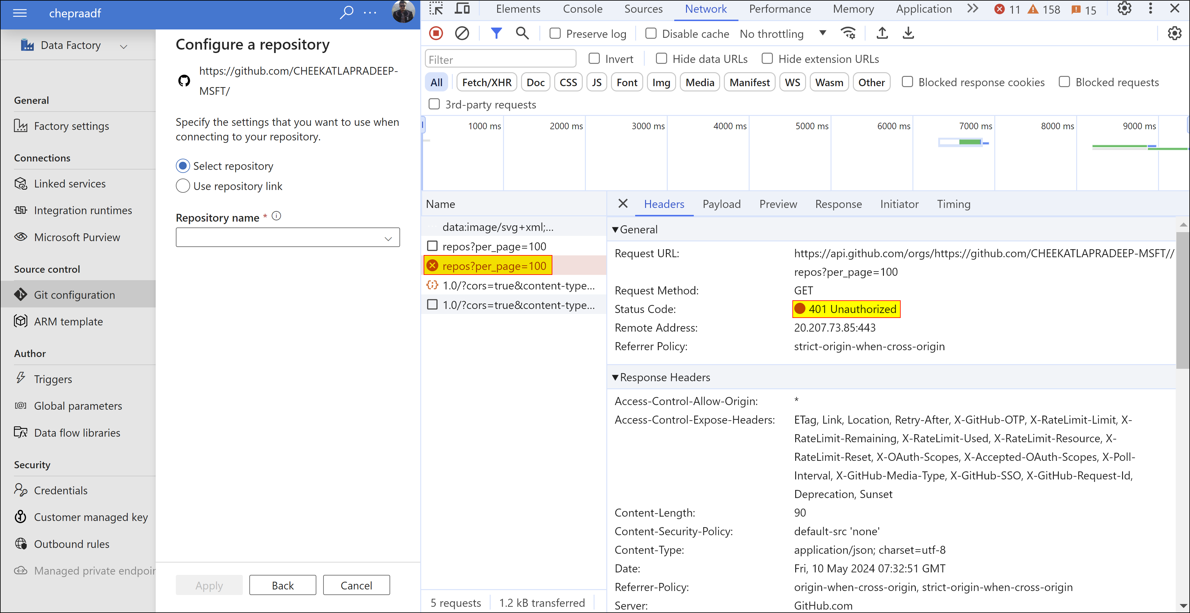

    It seems like you are having trouble setting up Azure Data Factory authentication with your personal GitHub account. You will experience this error when you are unable to authorize the Github account.
    In general, when you connect to a GitHub organization for the first time in Azure Data Factory, you need to enter the organization name in the GitHub Account field in the Git configuration pane. Then, you will be prompted to log in to GitHub using your user credentials. After logging in, you will be asked to authorize Azure Data Factory as an application called AzureDataFactory. On this screen, you will see an option to grant permission for ADF to access the organization. If you don't see the option to grant permission, ask an admin to manually grant the permission through GitHub.
