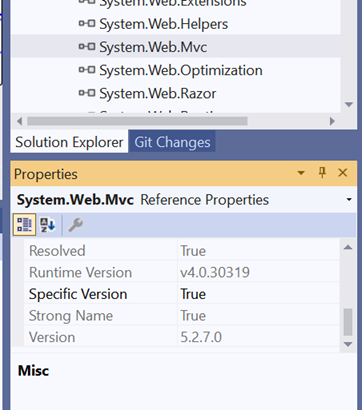

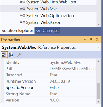

Here are y two projects : Mbsa.dll and then MBSAnalysisMVCWebApp.
Mbsa.dll
I want to access a controller method in MBSAnalysisMVCWebApp, from an Mbsa controller method.
 MBSAnalysisMVCWebApp has a system.web.mvc of 5.7.2.0 Mbsa a system.web.mvc of 4.0.0.1.

Assembly
'MBSAnalysisMVCWebApp' with identity 'MBSAnalysisMVCWebApp,
Version=2024.5.11.25, Culture=neutral, PublicKeyToken=null' uses
'System.Web.Mvc, Version=5.2.7.0, Culture=neutral,
PublicKeyToken=31bf3856ad364e35' which has a higher version than referenced
assembly 'System.Web.Mvc' with identity 'System.Web.Mvc, Version=4.0.0.1,
Culture=neutral, PublicKeyToken=31bf3856ad364e35'
Mbsa Not sure of what I am doing wrong?
