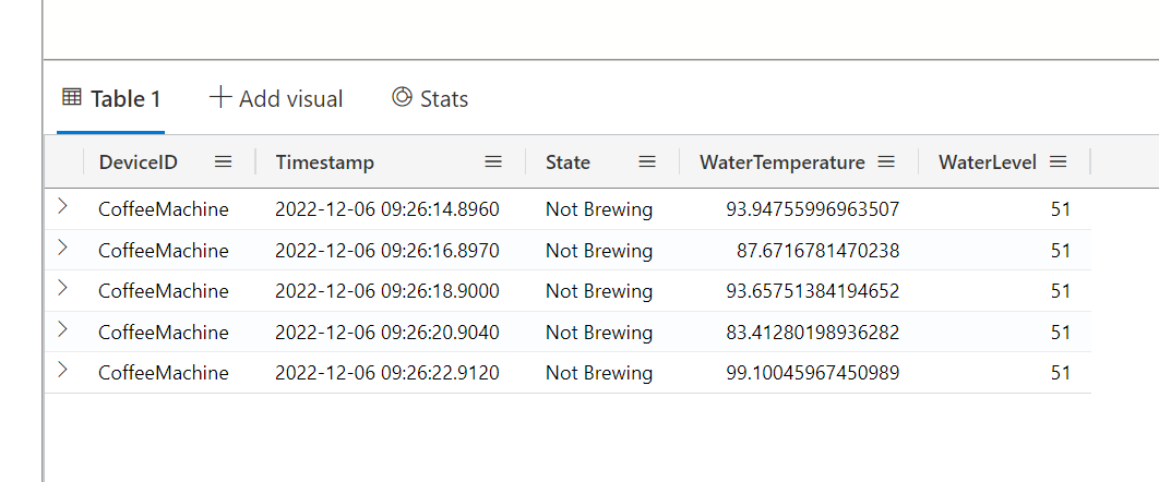

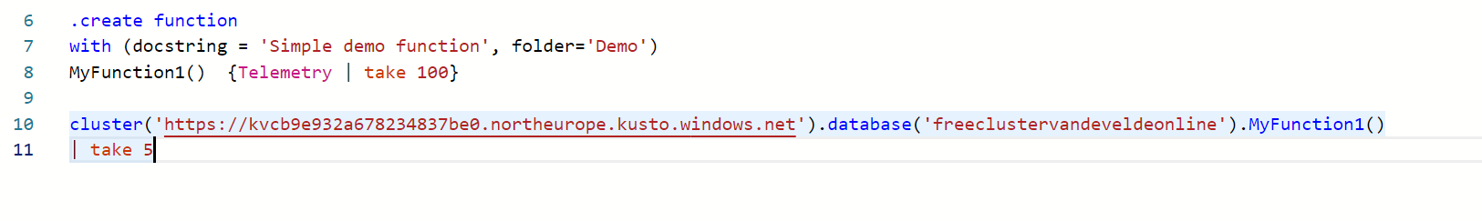

    I tried to replicate your example:
    cluster('https://kvcb9e932a678234837be0.northeurope.kusto.windows.net').database('freeclustervandeveldeonline').MyFunction1()
    | take 5
    I was based on an existing stored function:
    Notice I added round brackets '()' at the end, after the function name.
    This gives a correct result:
    Can you add the round brackets and check your query again?
