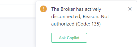

But when I try to send message to Eventgrid via MQTT I get following error:
I have been added permission bindings for Subscriber. I read manual (https://learn.microsoft.com/en-us/azure/event-grid/mqtt-publish-and-subscribe-portal).
Where could be the problem?

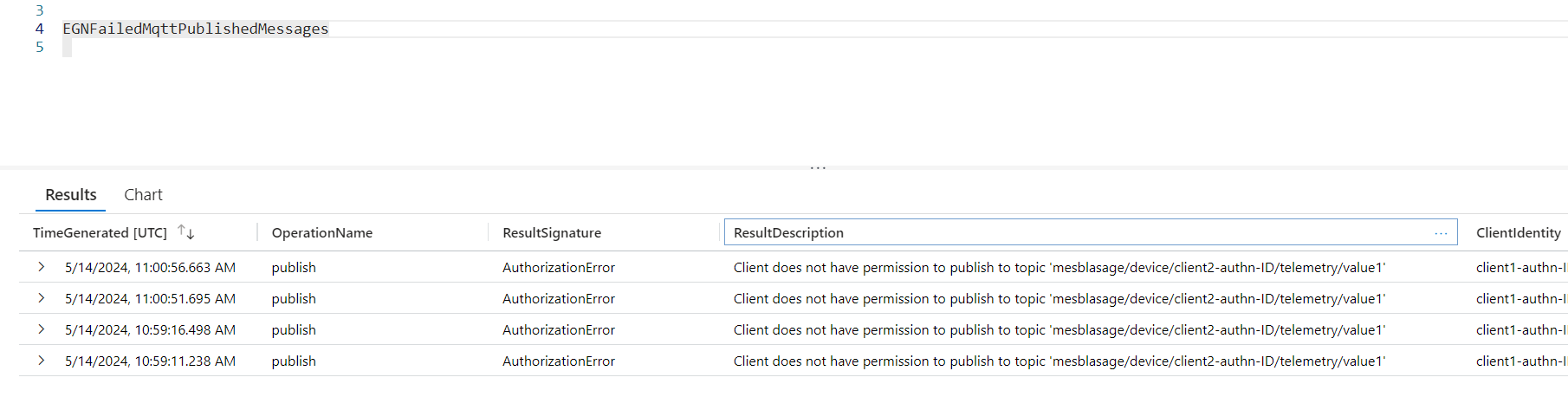

    Double check the topic you use to send a message with the permission bindings:
    It feels like a mismatch in that area, I get the same 135 error message when I misconfigure the publish topic.
    For a full working example see this blog post. At the end you can find a link to video with a demonstration.

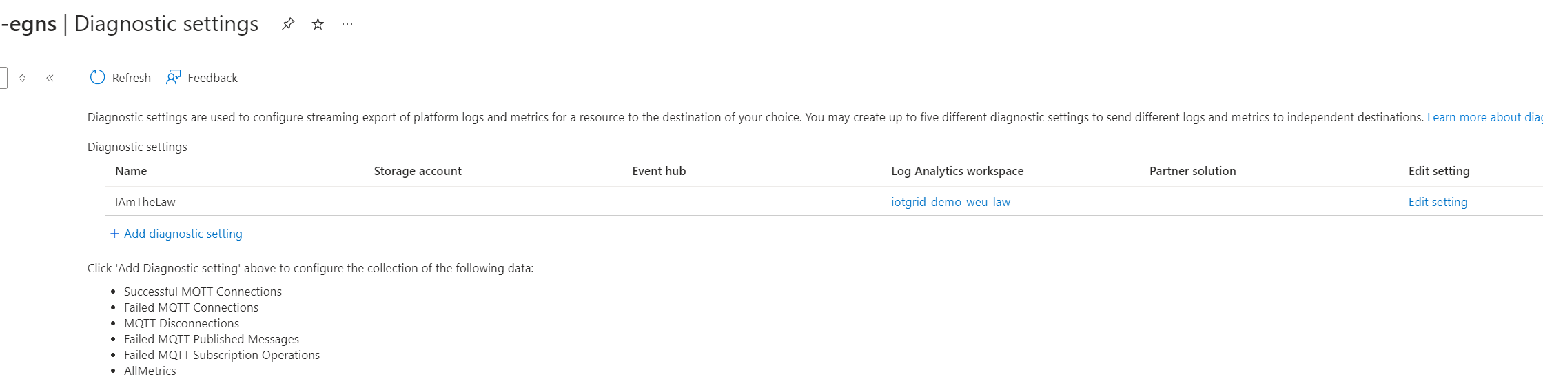

    Did you enable the diagnostic settings:
    You can check the table with a little more info:
