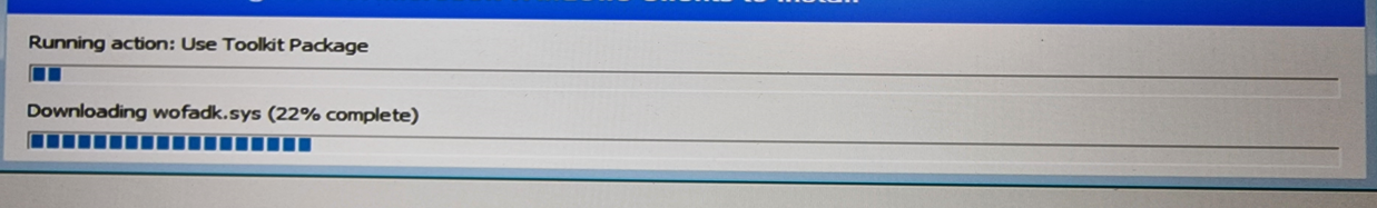

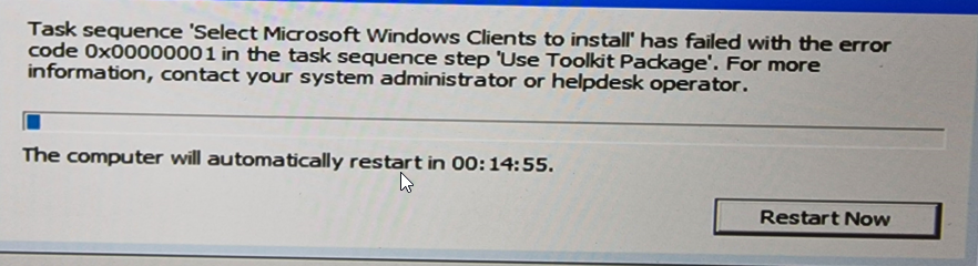

I have upgraded my SCCM 2207 to SCCM 2403 successfully. It seems everything does work. Today I wanted to use UDI Designer to install OS with TS, I am getting Error message with Error Code
Task Sequence has failed with the error code 0x00000001 in the task sequence step 'Use Toolkit Package.
on on the smslog file
Failed to run the action: Use Toolkit Package. Error 1
C:_SMSTaskSequence\Packages\DIG00545\Scripts\ZTISCCM.wsf(2, 11) Windows Script Host: The value for the attribute is not valid : language
Let the parent group (Gather Logs and StateStore on Failure) decides whether to continue execution

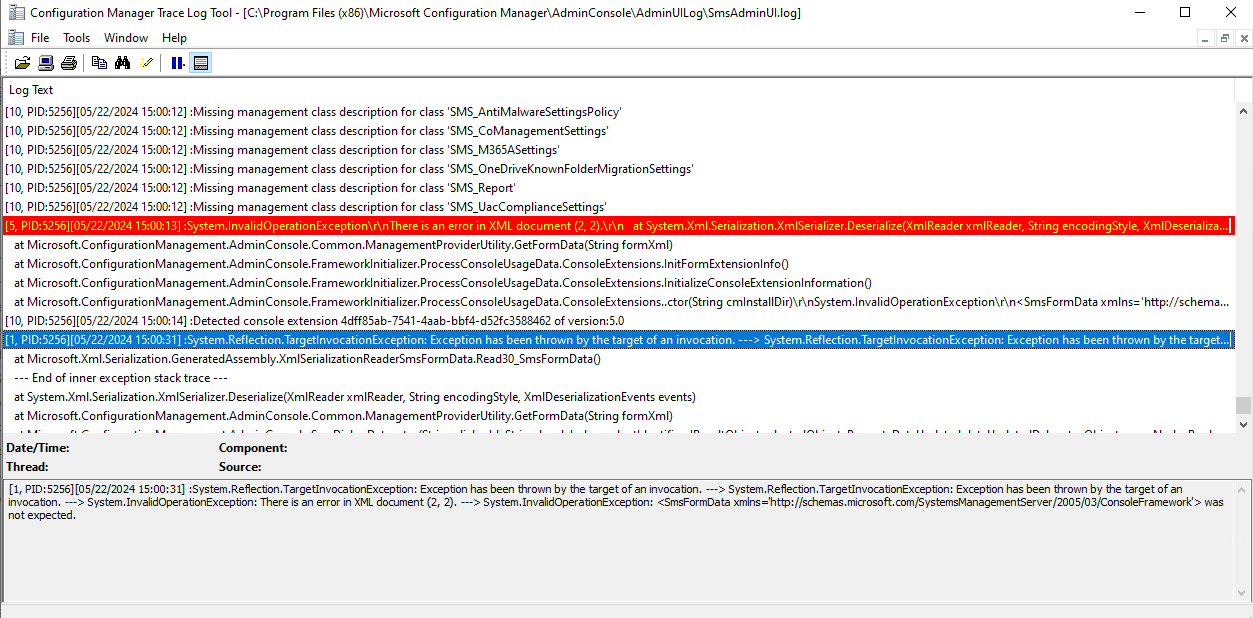

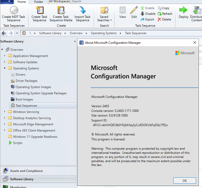

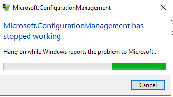

  2. XinGuo-MSFT 22,231 Reputation points
    2024-05-22T07:10:55.4766667+00:00
    CM:2403 + MDT:8456.1000
    When attempting to create an MDT Task Sequence, the Configuration Manager console crashes.
