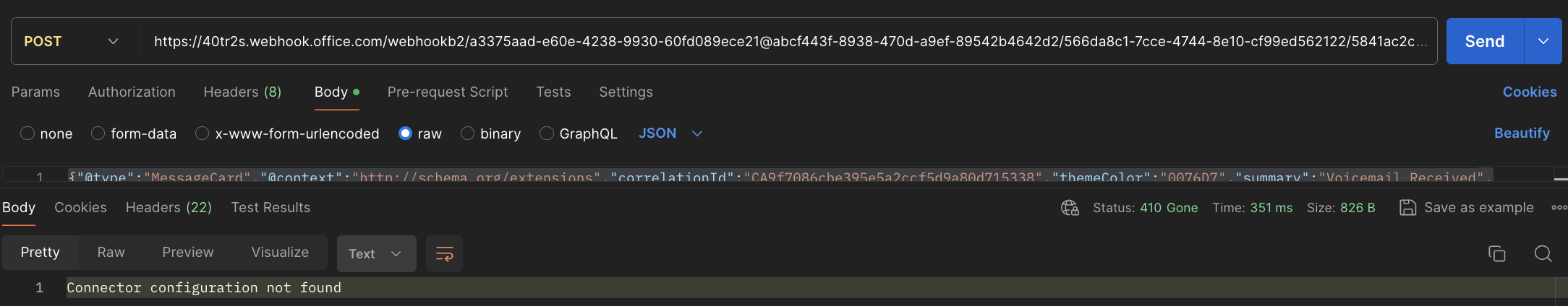

Upon investigation, we found that the webhook URL fetched during the connection process from the teamsjs library is not working. While trying to send connector messages to the received webhook URL, we received an error message saying Connector configuration not found with error code 410 (gone).
Sharing here a screenshot for reference:failed

  1. While setting up JustCall Connector, when the Connector configuration page loads, we use the microsoftTeams.settings.getSettings() method from the teamsjs lib. to fetch the webhook URL for the new configuration. But if we try to send messages via this URL, it fails with the error status and message mentioned above.

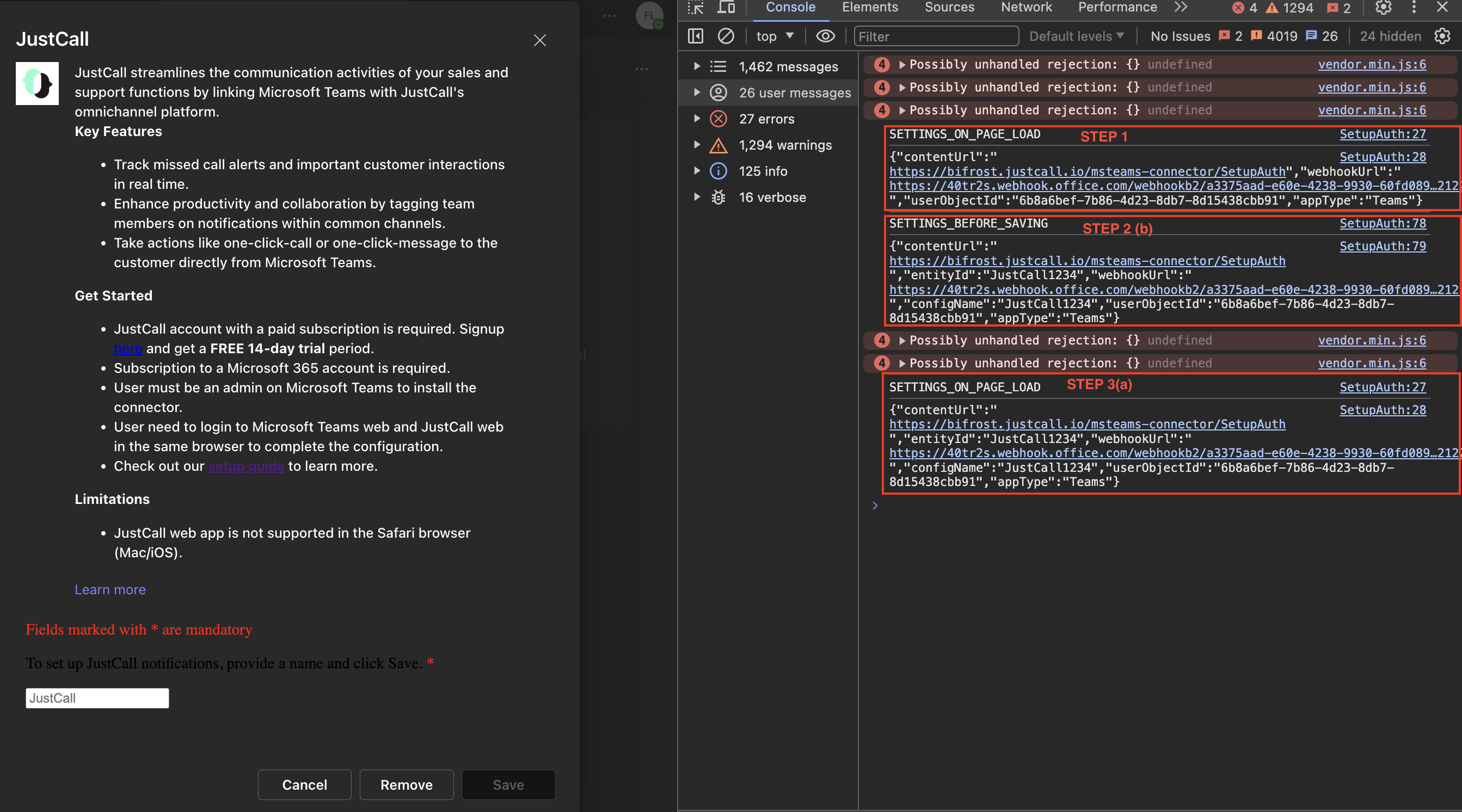

    1. then, fetch the settings using the microsoftTeams.settings.getSettings() method (Note: returns the same webhook URL received in step 1, however, messages still cannot be sent via this connector)
      failed_1

      1. Now, the configuration page loads and microsoftTeams.getSettings() method is used to fetch the webhook URL for the current (connected) configuration. This connector URL received this time is different from the Webhook URL received in step 1 and step 2 (a). While trying to send messages via this URL, it works and the message gets logged in the Microsoft Teams channel.
      2. So the issue is that the webhook URL received by us during the connection process( Step 2 (b) ) had changed during the save process on the Microsoft Teams end. This has been confirmed in step 3 (a)
Complete Webhooks URL received:
STEP 1: https://40tr2s.webhook.office.com/webhookb2/a3375aad-e60e-4238-9930-60fd089ece21@abcf443f-8938-470d-a9ef-89542b4642d2/566da8c1-7cce-4744-8e10-cf99ed562122/5841ac2c48ad494ab7e49e7e7773b4ef/6b8a6bef-7b86-4d23-8db7-8d15438cbb91
STEP 2 (b): https://40tr2s.webhook.office.com/webhookb2/a3375aad-e60e-4238-9930-60fd089ece21@abcf443f-8938-470d-a9ef-89542b4642d2/566da8c1-7cce-4744-8e10-cf99ed562122/5841ac2c48ad494ab7e49e7e7773b4ef/6b8a6bef-7b86-4d23-8db7-8d15438cbb91
STEP 3 (a): https://40tr2s.webhook.office.com/webhookb2/a3375aad-e60e-4238-9930-60fd089ece21@abcf443f-8938-470d-a9ef-89542b4642d2/566da8c1-7cce-4744-8e10-cf99ed562122/d131da8c61d543779ed98dc52ea93cec/6b8a6bef-7b86-4d23-8db7-8d15438cbb91
