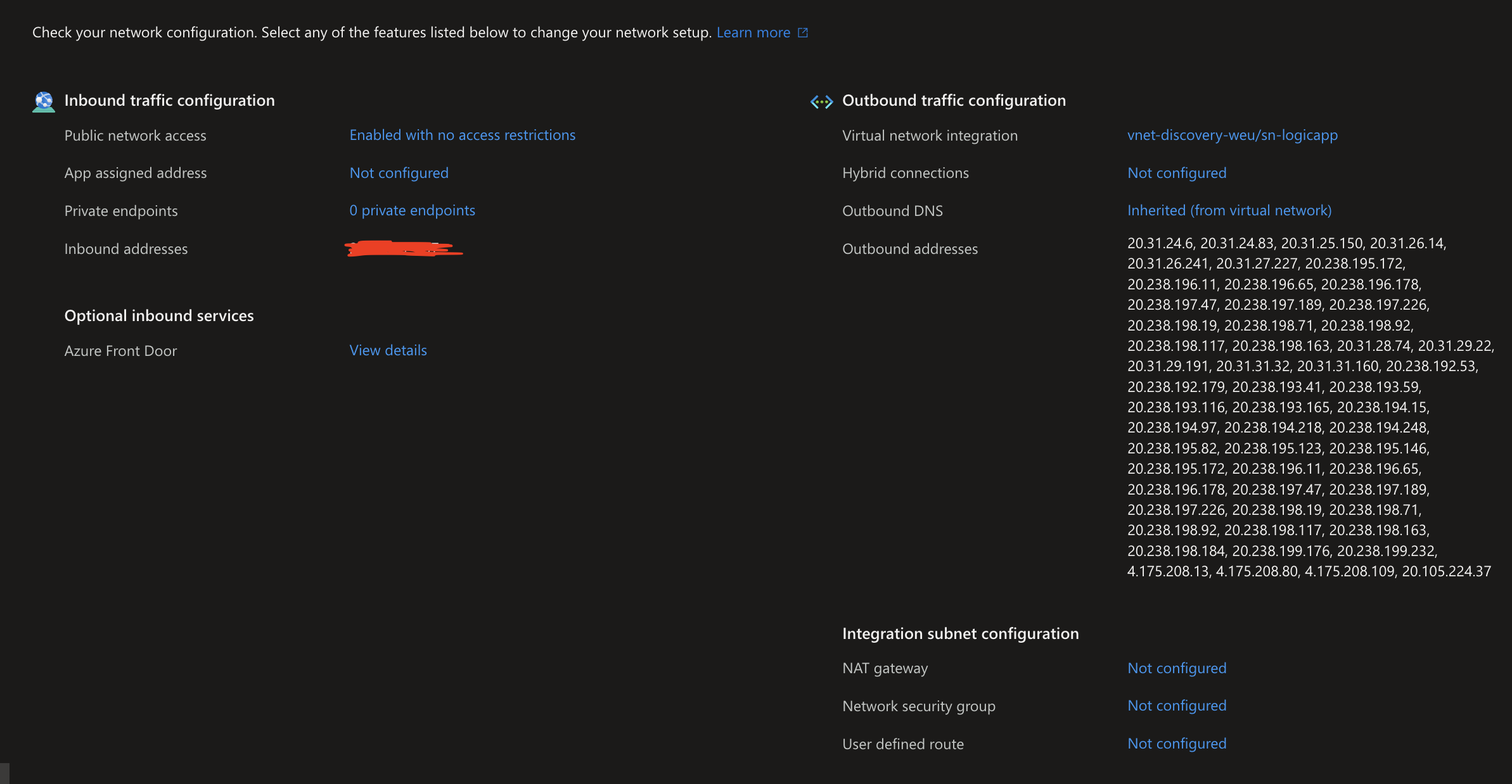

I have created an Azure Logic App with public access (Inboud) and VNET integration in the outbound. This is the network config:
Screenshot 2024-05-16 at 08.07.07

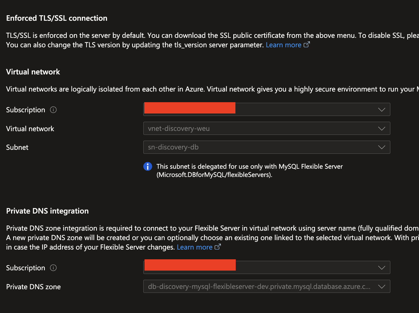

On the other hand, in the Virtual Network linked to the Logic App, there is a private Azure Database MySQL Flexible Server. This is the network config:
Screenshot 2024-05-16 at 08.10.39
There is no Network Security Groups nor any service, rule or other security related service (Firewall, Route...).

  1. Ben Gimblett 4,560 Reputation points Microsoft Employee
    2024-05-17T13:55:42.62+00:00
    Hi - if you're seeing this "code": 502, "source": "0a7c12e12fd2b8d7.07.common**.logic-westeurope.azure-apihub.net**", , "message": "BadGateway" Then it suggests you are using the managed-connector towards SQL
    As suggested by the source URL managed connectors are hosted in their own infra that cannot know of your VNET and network config
    basically the logic app calls out to the managed connector (http) - and by default the connector would require a public SQL endpoint to connect (TCP)
    The better choice here would be to use the built in or "in app" connector
    For more info on this please see here https://learn.microsoft.com/en-us/azure/connectors/connectors-create-api-sqlazure?tabs=consumption#connector-technical-reference
    Edit: See comments below - there's no built in connector for MYSQL but should be able to use OPDG (on prem data gateway with the managed connector to facilitate private comms)
    One easy way to tell - if you look for the connection , if it's "built in" it'll be under the "service provider" tab
