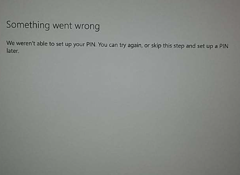

I have Windows 11 machine, Windows Hello for Business is setup and working, also PIN reset is working from Accounts setting area where Face and other settings are.
But not working from Lock screen
Non destructive is enabled, 2 apps are already allowed in M365 portal which are required for PIN service.
Also device wipe also tried but same result after wipe

  2. Syed Muhammad Faisal 35 Reputation points
    2024-05-21T15:32:21.81+00:00
    Thanks for your reply, interestingly when i add comments, they are not visible so adding in reply in Answer area,
    Below is the screen, same issue on 2 different machines, with multiple device wipe try.
    Also devices are compliant and no other issue
