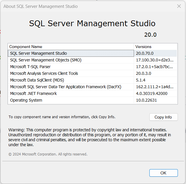

unable to connect another data base in same server which is azure sql - through ssms
Srinivas Mantri 0 Reputation points
2024-05-17T05:49:15.5066667+00:00
Issue description:
Msg 40515, Level 15, State 1, Line 66
Reference to database and/or server name in 'sriniazpracticedbserver.database.windows.net.TARGET.dbo.data_trg' is not supported in this version of SQL Server.
Completion time: 2024-05-17T11:12:27.1510005+05:30
