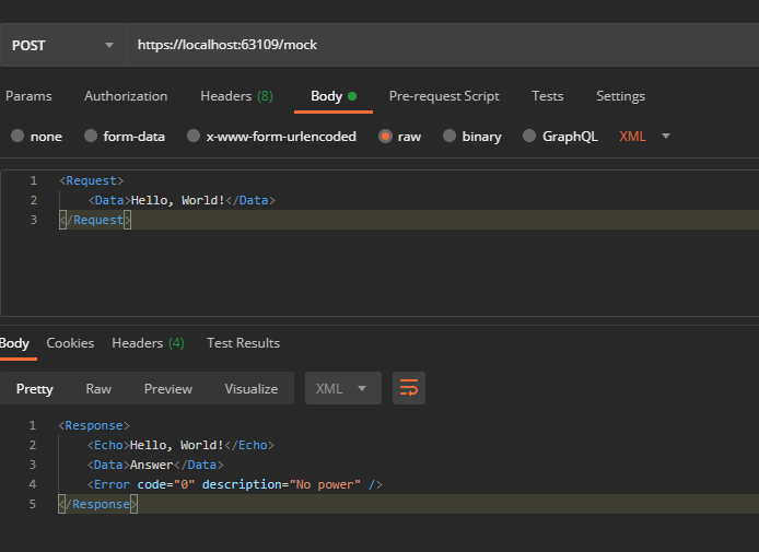

To set up a mock server to test the interface and receive predefined XML responses, you can use ASP.NET Core to Create a Mock Server. It's simpler than SoapUI or Postman for creating a mock server.
- Create a New ASP.NET Core Web Application:
- Open Visual Studio and create a new ASP.NET Core Web API project.
- Define the Controller:
- Add a controller to handle incoming requests and send predefined XML responses.
using Microsoft.AspNetCore.Mvc; using System.Xml.Linq; namespace MockServer.Controllers { [Route("api/[controller]")] [ApiController] public class TestController : ControllerBase { [HttpPost] public IActionResult Post([FromBody] XElement request) { // Define the response based on some logic or input request XElement response = new XElement("Response", new XElement("Data", "Answer"), new XElement("Error", new XAttribute("code", "0"), new XAttribute("description", "No power")) ); return Content(response.ToString(), "application/xml"); } } }
- Run the Server:
- Build and run the project. This will host your mock server locally, typically on
https://localhost:5001or similar.

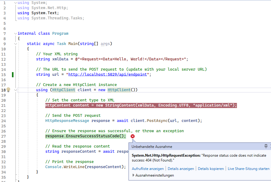

Here’s the C# client code to send a request to your mock server and receive the predefined response:
using System;
using System.Net.Http;
using System.Text;
using System.Threading.Tasks;
class Program
static async Task Main(string[] args)
// Your XML string
string xmlData = @"<Request><Data>Hello, World!</Data></Request>";
// The URL to send the POST request to (update with your local server URL)
string url = "https://localhost:5001/api/endpoint";
// Create a new HttpClient instance
using (HttpClient client = new HttpClient())
// Set the content type to XML
HttpContent content = new StringContent(xmlData, Encoding.UTF8, "application/xml");
// Send the POST request
HttpResponseMessage response = await client.PostAsync(url, content);
// Ensure the response was successful, or throw an exception
response.EnsureSuccessStatusCode();
// Read the response content
string responseContent = await response.Content.ReadAsStringAsync();
// Print the response
Console.WriteLine(responseContent);
