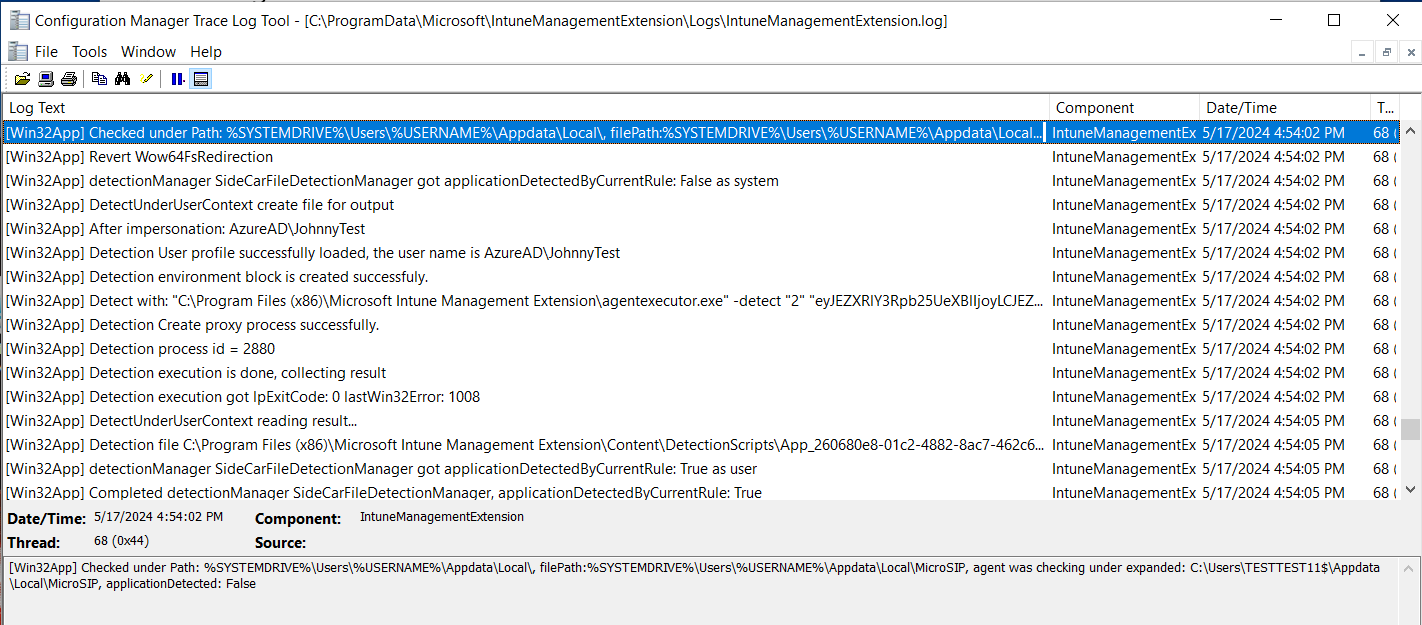

Hey guys,
So I cant figure out why my script is not working. I am trying to uninstall a application called MicroSIP (website: microsip.org) via Microsoft Intune on all of our Windows machines but the script is says "not installed" or "error" every time I run it. I have tied multiple scripts but no luck. I did find my issue. So here it is. Every time the script runs it looks under C:\Users for the name of the MACHINE instead of the USER when expanding %USERNAME%. Can someone please help me fix this? Here is my script and screen screenshot of Intune Log.

  1. Gowtham CP 7,085 Reputation points Volunteer Moderator
    2024-05-18T03:54:49.9033333+00:00
    Hello Johnny T ,
    Thank you for reaching out on Microsoft Q&A.
    I have updated the script to correctly reference the user profile paths using a parameter within the function, ensuring the correct user-specific paths are targeted during the uninstallation process. I have also removed Redundant function calls to improve the efficiency.
