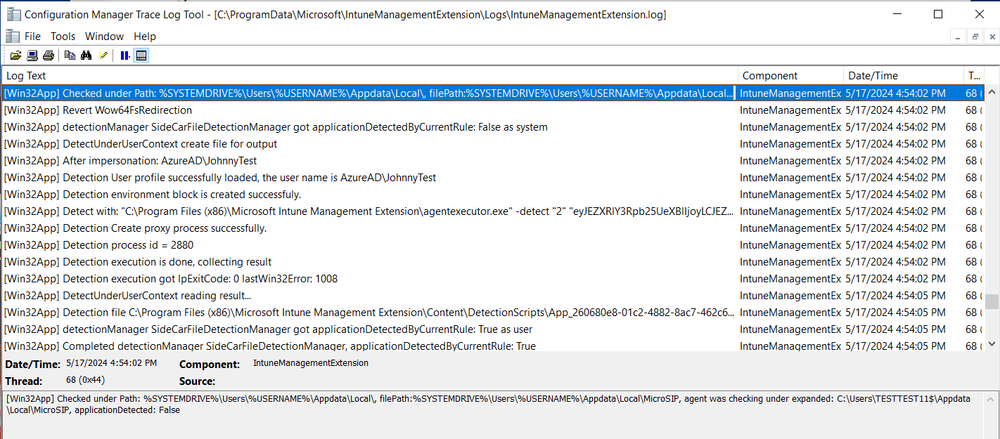

Johnny T 0 Reputation points
2024-05-17T22:50:49.1433333+00:00
I am trying to uninstall a application called MicroSIP via Microsoft Intune on all of our Windows machines but the script is says "not installed" every time I run it. I have tied multiple scripts but no luck. I did find my issue. So here it is. Every time the script rans it looks under C:\Users for the name of the MACHINE instead of the USER when expanding %USERNAME%. I have not idea what I am doing wrong

    Hi Jt I see the issue in your script. The problem is that you're using environment variables in a string that's being passed to cmd.exe, but PowerShell doesn't expand these variables in that context. Let's modify the script to fix this and improve its overall structure:

    changes and improvements:
    We're now using Join-Path to create the path to the uninstaller, which is more reliable than string concatenation. Instead of using cmd.exe, we're using Start-Process to run the uninstaller directly. This avoids issues with environment variable expansion. We've added error handling to capture the exit code of the uninstaller process. The script now checks each user profile only once, instead of the previous four repetitions. We've improved the logging to provide more informative output.
    This script should work correctly when deployed via Intune. It will iterate through all user profiles on the machine and attempt to uninstall MicroSIP from each profile where it's installed. Remember that when running this script via Intune, it will typically run in the SYSTEM context. This means it will have access to all user profiles, but won't have any specific user's environment variables loaded. The script as written doesn't rely on these variables, so it should work correctly.
