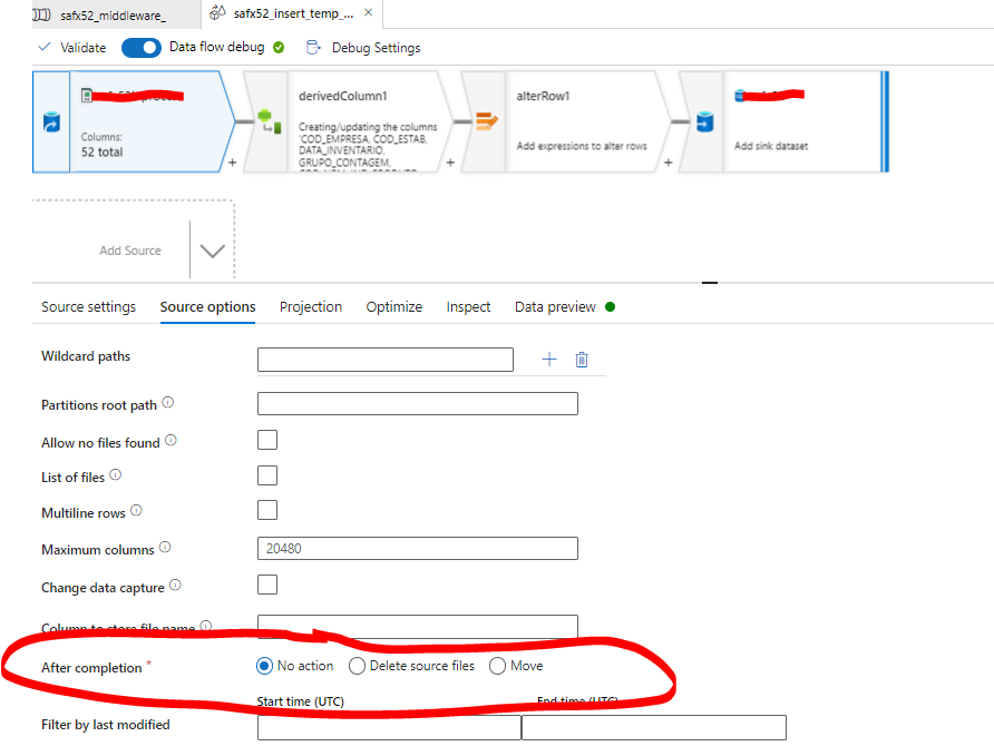

I’m facing the issue below.
I have a Data Flow that inserts a filter into an Azure SQL DB. I’ve set it to “Delete source files” after completion, but it’s still generating a log in the Blob storage, which I don’t want.
So, I changed it to “No action again,” but it’s still generating the log in the Blob Storage.
The Data flow:

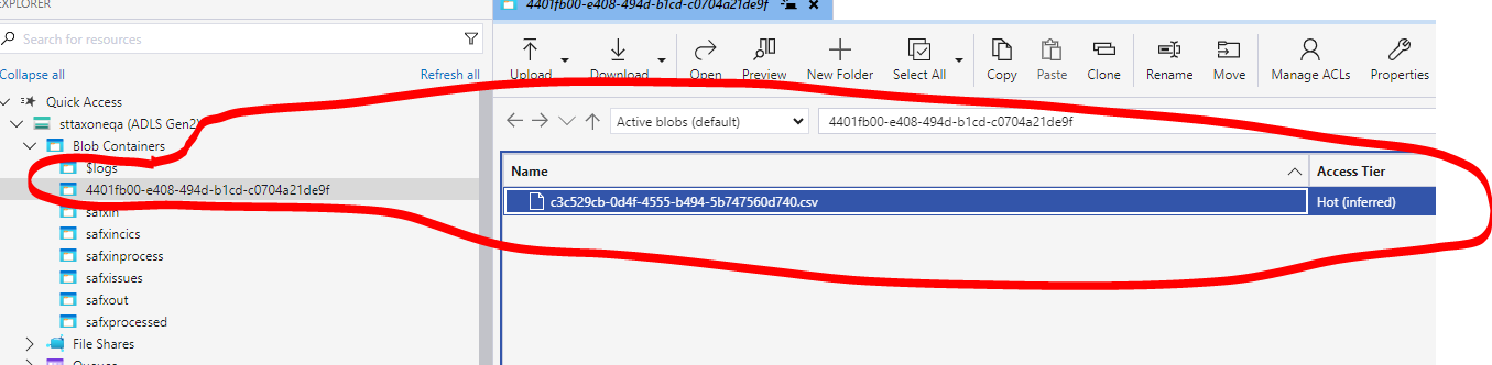

The log, the one that I don't want to be generated anymore:
I have already created a new data flow, changed the name, and so on, but nothing is resolving the issue.

    This is a known behaviour in Azure Data Factory (ADF) where a branch exists whether or not any rows are fed to it, so the Sink will still run. In the case of storage sinks, a 0-byte blob will be created.
    Here are a couple of suggestions that might help:
    • Use Cache Sink: If you don’t wish to write output to an external source, you can use a cache sink. It writes data into the Spark cache instead of a data store. In mapping data flows, you can reference this data within the same flow many times using a cache lookup.
    • Delete Empty Files Programmatically: If you still want to delete empty zero-byte files, you can use ADF or a programmatic method to delete them at the end of execution.
    References:
    https://stackoverflow.com/questions/68404511/zero-bytes-files-are-getting-created-by-adf-data-flow
    Also, if my response helped resolve your issue, could you please mark this answer as accepted? Thank you!
