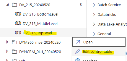

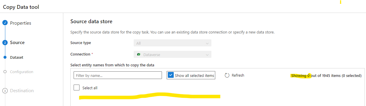

Edit Control Table. If I try and edit the control table, the configuration data does not fully load, and the list of source tables is not populated in the wizard.
