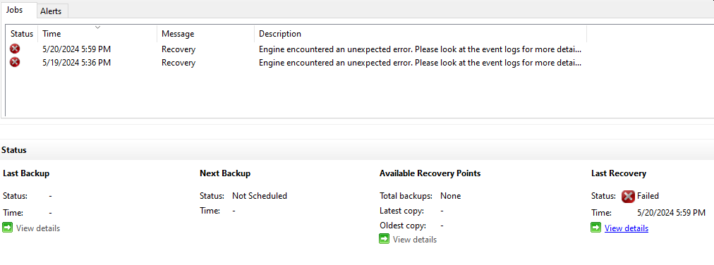

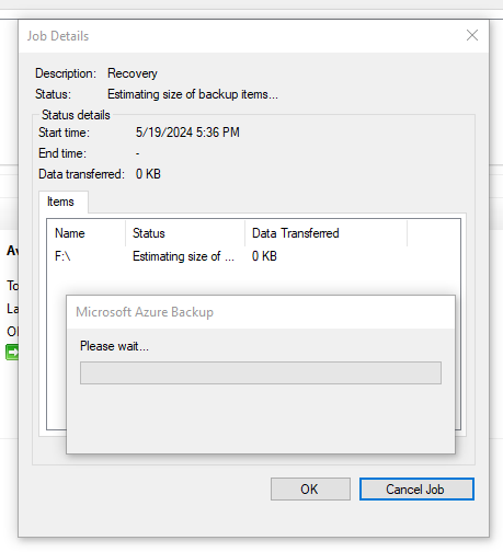

Hi, I've been attempting to start a full volume recovery from MARS, however it has been stuck at "Estimating size of Backup items..." for 24 hours and I believe there is nothing currently in progress.
Stuck cancelling

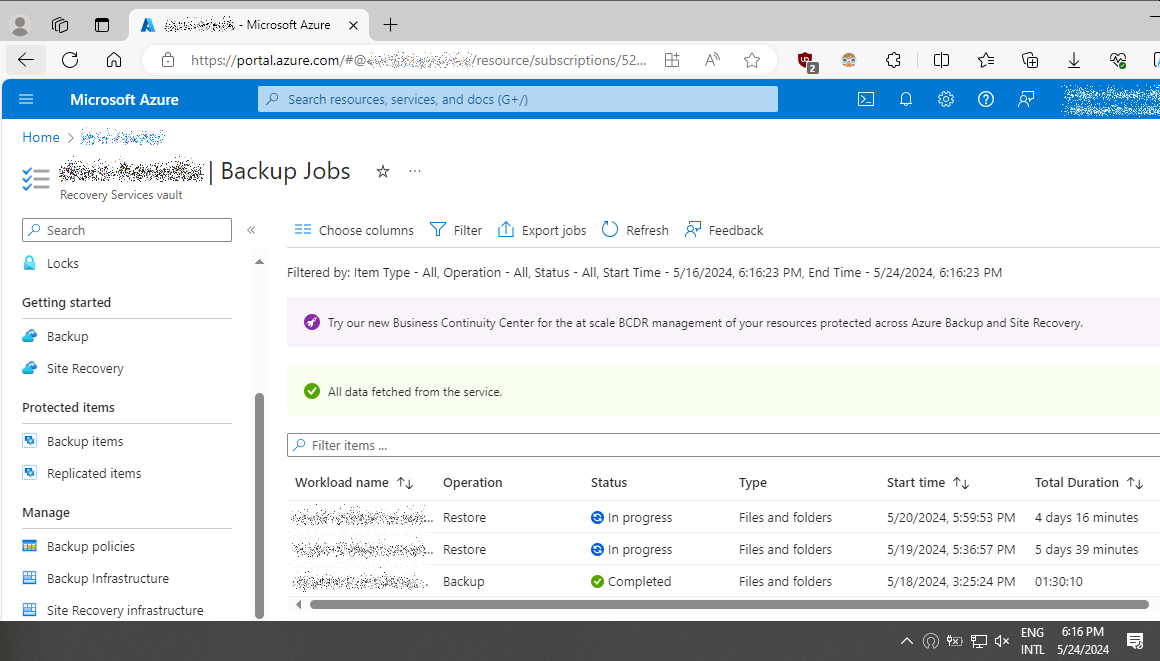

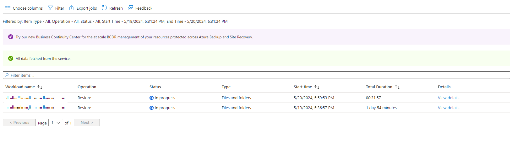

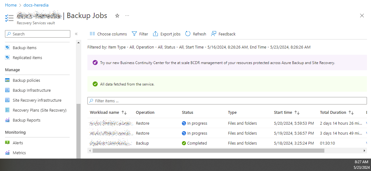

Additionally, on the Backup jobs blade in portal.azure.com it appears as the restore is still running:
Running jobs
For context, the full backup is around 2.68TB, and about 600k files.
There are no logs on the Windows Event Viewer computer where MARS is running.
Could someone please point me to the right direction to further troubleshoot this?

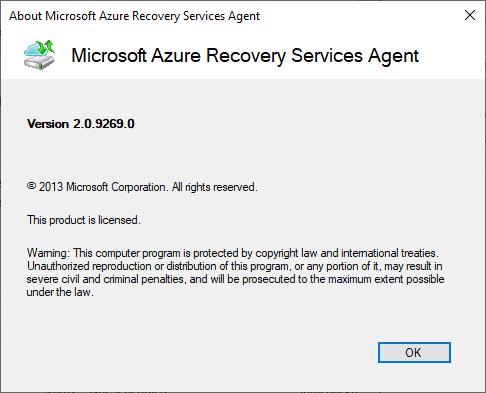

    1. First thing, please ensure that you are running the latest version of MARS agent [Version. 2.0.929] - download it from here or from the Azure portal as mentioned in this section.
    If you are already using the latest version of MARS agent, there are a few things you can try to resolve the issue:
    1. Since you mentioned that the restore job still appears to be running in the Azure portal, try cancelling the job from there if possible. Sometimes, jobs can get stuck on the MARS agent side but still appear as running in the portal. Cancelling the job from the portal might help to resolve the issue.
