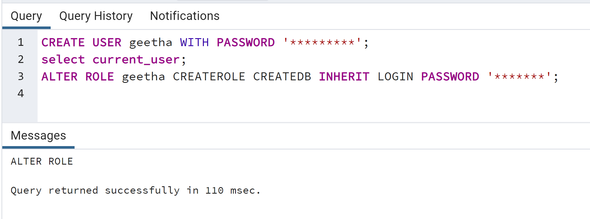

    @Davi, Thomas Thanks for sharing additional information, yes this is part of Postgres 16 limitation which you can go through here https://www.postgresql.org/docs/16/release-16.html
    To resolve your issue, you can modify the role as shown sample below, let me know if you find any issue.

    I've tried what you suggested above but I couldn't do much with it.
    Can you explain it more thoroughly or provide any other solution?
