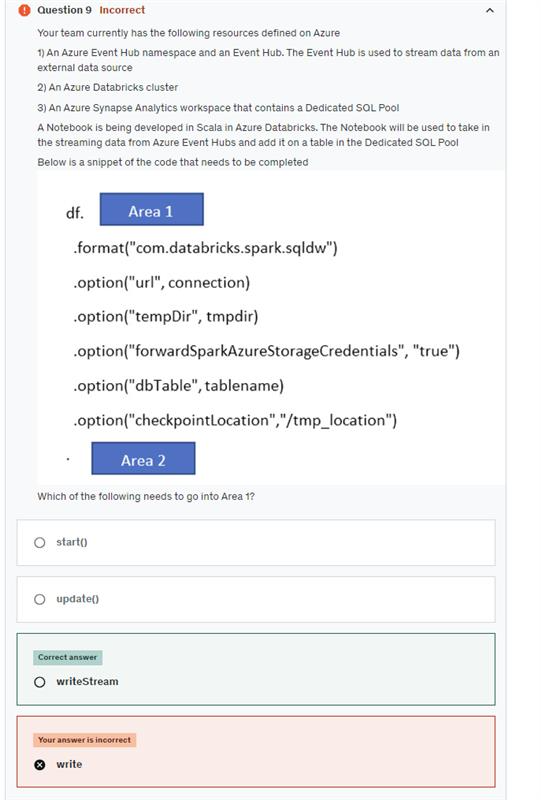

I have test exam questions for dp 203 and i had the following question
after the answer, it shows that it is wrong and gives a link to the documentation

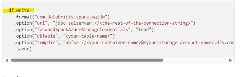

https://learn.microsoft.com/en-us/azure/databricks/connect/external-systems/synapse-analytics
In docs i see this:
Who is right?

    @Darjuš Vasiukevič - Thanks for the question and using MS Q&A platform.
    Accordingly, to the document which you shared the correct answer would be: df.write
    Let's understand the difference between df.write and df.writestreamin Azure Databricks.
    df.write and df.writestream are two different methods used in Azure Databricks for writing data to a destination.
    df.write is used to write a batch DataFrame to a destination. It is a synchronous operation, which means that the write operation will complete before the next line of code is executed. This method is used to write data to a destination that does not require continuous updates, such as a file system or a database.
    On the other hand, df.writestream is used to write a streaming DataFrame to a destination. It is an asynchronous operation, which means that the write operation will continue to run in the background while the next line of code is executed. This method is used to write data to a destination that requires continuous updates, such as a streaming service or a real-time dashboard.
    In summary, df.write is used for batch processing, while df.writestream is used for streaming processing.
    Please note: The content posted by Udemy learning platform is not monitored and maintained by Microsoft, please do reach out to the owner of the practice test or the Udemy support: https://support.udemy.com/hc/en-us
    Hope this helps. Do let us know if you any further queries.
