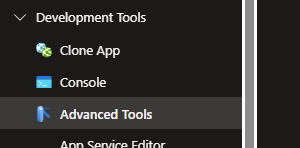

    Using advanced tools(kudo) on the app service you can start testing by curl command to the DB port and verify the proper name resolution.

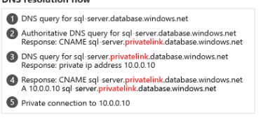

      The IP 168.63.129.16 Enables communication with the DNS virtual server to provide filtered name resolution to the resources.
    • Follow the validation process here and use nameresolver <Azure SQL DB name>.<Azure SQL DB private DNS zone name> from the Kudu console to validate the DNS resolution.
    Regarding your question above
    Sorry, if I may ask. If my servername is FancySqlServer.database.windows.net, should I use FancySqlServer.privatelink.database.windows.net or FancySqlServer.database.windows.net to connect to the sql server?
    I think you should use FancySqlServer.privatelink.database.windows.net although I think the DNS resolution should work for both FQDN's as documented here when the DNS resolution is tried from a linked VNET it should resolve FancySqlServer.database.windows.net to the private IP using the CNAME record.
