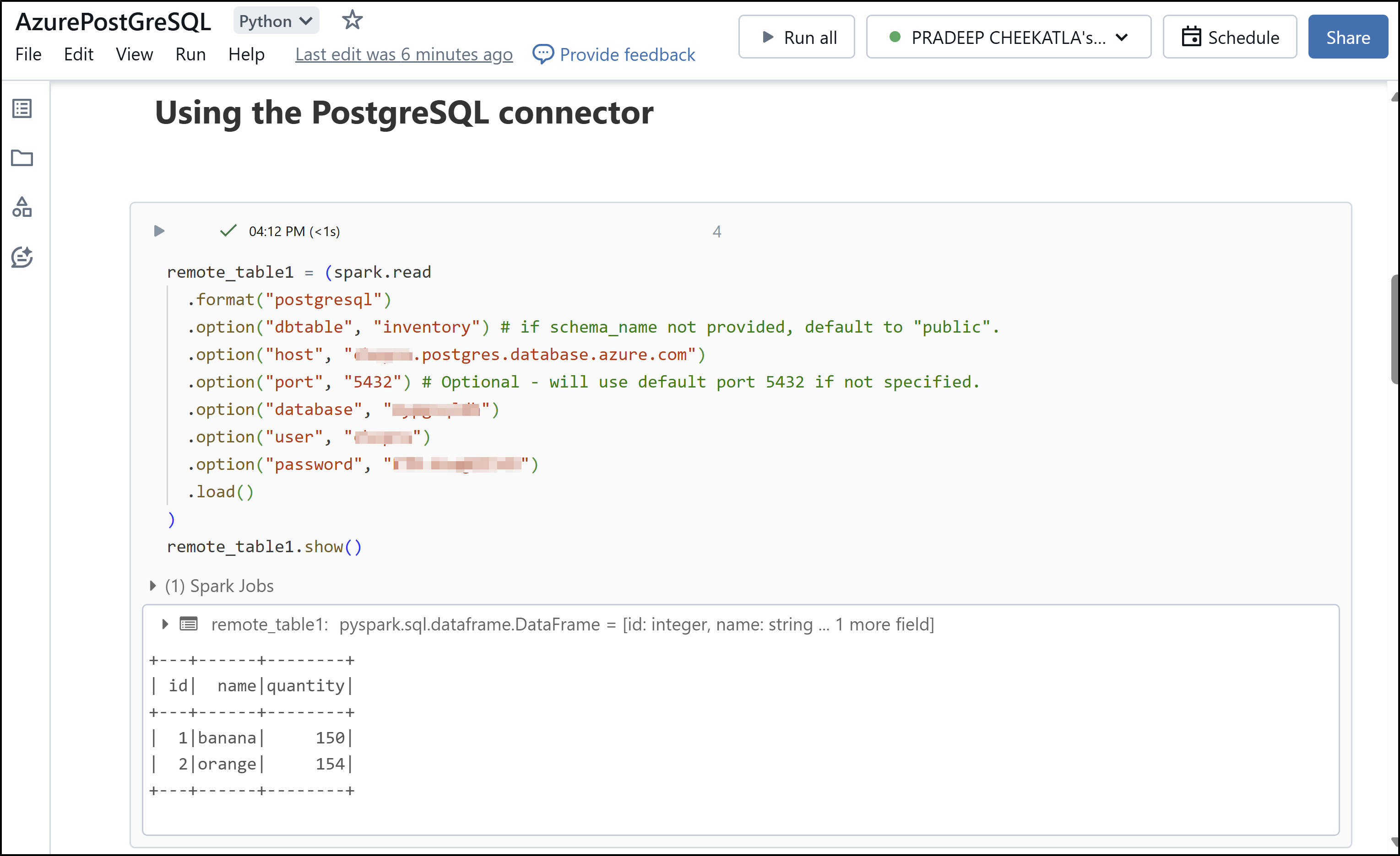

    The sample queries to connect to Azure Database for PostgreSQL using Azure Databricks using PostgreSQL connector:
    remote_table = (spark.read
      .format("postgresql")
      .option("dbtable", "schema_name.table_name") # if schema_name not provided, default to "public".
      .option("host", "database_hostname")
      .option("port", "5432") # Optional - will use default port 5432 if not specified.
      .option("database", "database_name")
      .option("user", "username")
      .option("password", "password")
      .load()
    Here is the screenshot of the successful connection:
