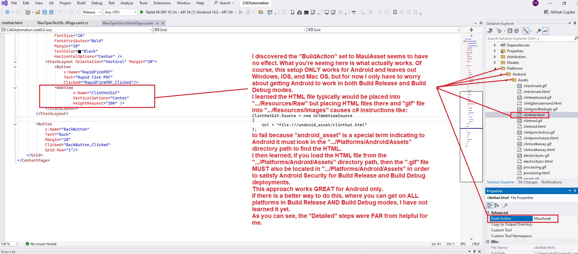

Has anyone figured out how to get a MAUI Image "gif" animation to work in Release mode?
Using Visual Studio 2022's Android Device Manager, Emulator set to Tablet M-DPI 10.1in - API34, Android 14.0 - API 34, the MAUI Image animation in Debug mode works every single time!  Awesome!  However, when I switch the Build to Release mode and Deploy to the Emulator, the application responds just fine but I see a Image control presenting a FROZEN "gif" and I don't know how to solve the problem.
I experience the same FROZEN "gif" problem if the Emulator is running Pixel 6 Pro Android 14 - API 34.
Using the Debug build, Pixel 6 Pro Android 14 - API 34 Emulator shows the Image control animating the "gif" perfectly!
However, switching Build to Release mode and Deploying to the Pixel 6 Pro Emulator, again I experience the application responding just fine, but the Image control presents a FROZEN "gif".

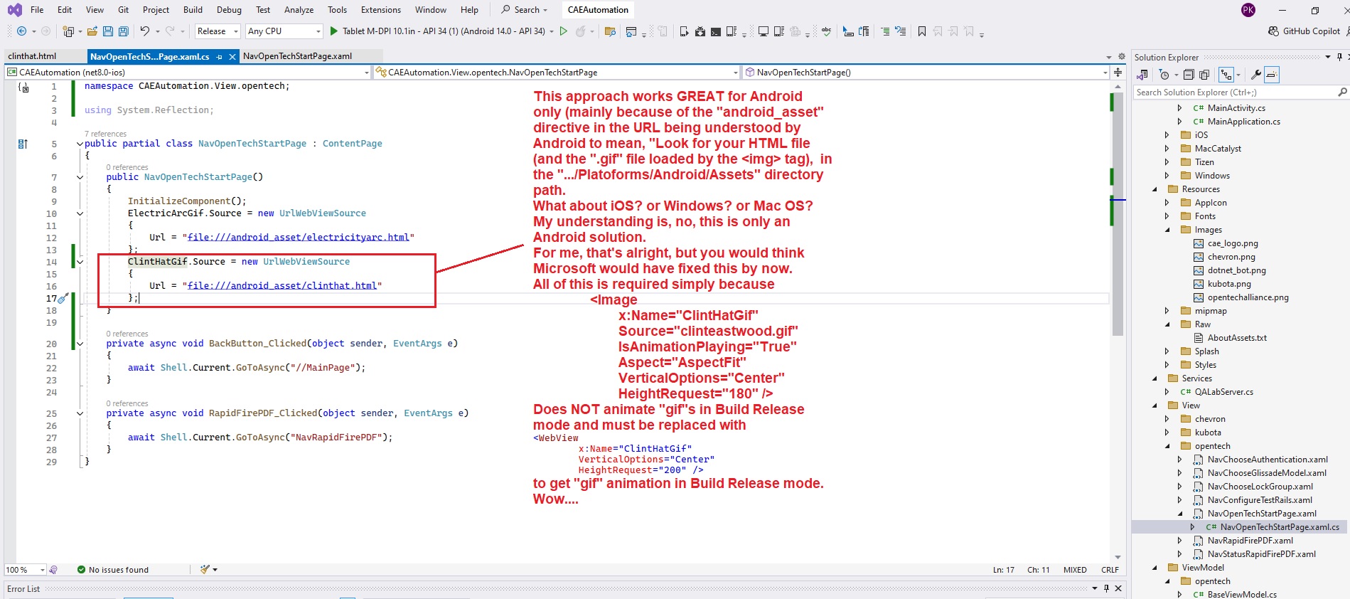

Here's my XAML definition for my Image element:
When I select my Project and visit "Manage NuGet Packages" and select the "Updates" tab, no updates appear. So, I think I've got the latest.
Maybe you know of a NuGet Package or a Build Release setting that solves the problem? I'm unsure how to proceed.

    Hello,
    This issue is reported in the MAUI github repo.Please track on this issue:.Net MAUI 7 Android, Image Gif Animation Not Playing in Release Mode, Normal in Debug Mode.
    Here is a workaround: please create a html and add gif in it. Use your webview to display this html page. I test it in Android emulator in release mode. it is working.
    Here are detailed steps. Or use plugin to show gif in this github link.
