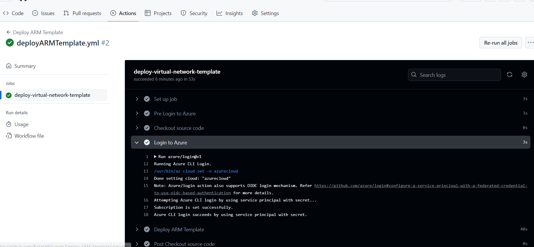

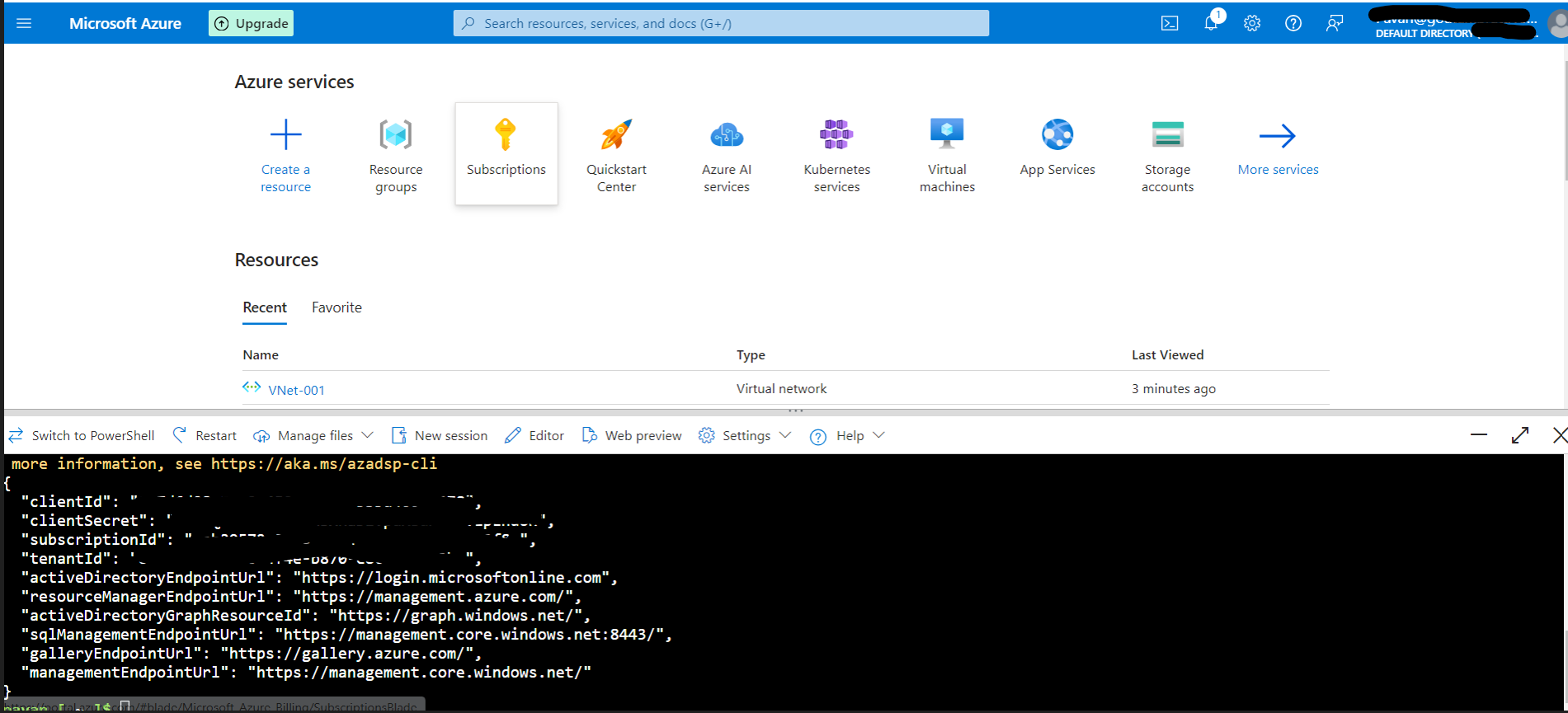

  1. Rakesh Gurram 15,700 Reputation points Microsoft External Staff Moderator
    2024-05-24T09:58:56.12+00:00
    Hi AJ,
    Thank you for your patience.
    We have successfully replicated the steps within the module. Please ensure that your assigned role is 'Contributor.' If it is not, assign yourself the 'Contributor' role and avoid using restricted Azure directories. Additionally, verify that the client secrets in both the CLI and GitHub secrets are correct and save them under Action secrets.
    p5
    This has been created resource within the given resource group. Resource Group>>Settings>>Deployments>>Created Resource (VNet) as shown:
    Please don't hesitate to reach out to us if you have any other queries with screenshots of the error (after concealing your PII).
