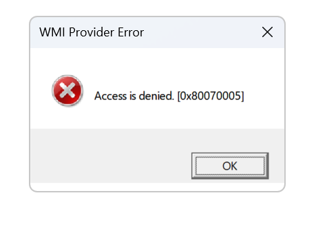

Hi All,
I wanted to enable TCP/IP protocols in SQL server configuration manager in my local but getting access denied error
Can any one please let me know how to resolve this issue and enable the protocols

    The obvious question is: Do you have sufficient permissions? SSCM fires a UAC prompt, but if you are not admin on your machine, that may not help. Is this your private machine or are you at work?
    Another possibility is that something is messed up inside WMI. A reboot can be worth trying.
    It could also be some anti-malware program that decided to guard these registry entries with its life and not letting you in.
    If you are in a work environment, and reboot does not help, I think you should talk to your IT folks.

    Hi,Anvitha Boyapati (V)
    The issue is largely related to permission issues.
    Is your operating environment a personal computer or within a domain?
    Make sure that SSCM has been run with administrative privileges and ensure that the group policy for domain users is set to modify network configurations.
    Some anti-malware software with high privileges may also block your operations, remember to disable them.
    Lastly, if the above checks are fine, you can try to repair the WMI Provider for SQL Server.
    For instance, 2022 version:
    Go CMD:
    cd C:\Program Files (x86)\Microsoft SQL Server\160\Shared
    Then:
    mofcomp "sqlmgmprovider.mof"
    For SQL Server 2019 and earlier versions:
    mofcomp "sqlmgmproviderxpsp2up.mof"
    Different versions refer to this.
