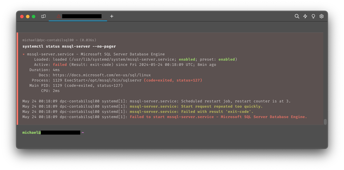

I couldn't find a proper way to install the SQL Server 2022 on Ubuntu Server 24.04 LTS, I tryed to use the microsoft SQL Server 2022 from Ubuntu 22.04 repo, but couldn't get the service running properly. I ended with this service status (see print).
Is there any way that I can get the service done?Captura de Tela 2024-05-23 às 21.35.32

    This is what ended up working for me. I looked up a lot of posts on this issue, so this will be a combination of solutions.
    If you are doing this on a fresh install of 24.04 server, you will still use the 22.04 Jammy MSSQL packages (at least as of the time of this post).
    The missing dependency install instructions came from this site
    https://medium.com/@mncubeharmony/resolving-sql-server-startup-issues-on-linux-missing-ldap-libraries-efc5b25e6063
    After you install those, you can follow the instructions on MS's site for installing MSSQL server on Ubuntu 22.04. It will give you the curl commands to download the keys and the sources list.
    https://learn.microsoft.com/en-us/sql/linux/quickstart-install-connect-ubuntu?view=sql-server-ver16&tabs=ubuntu2204
    Instruction 1 is going to have 2 links to download the public keys. Use the second one to get the public key to avoid warnings. Using the first curl command to get the public key will likely end up in getting this warning during apt update:
    W: Failed to fetch https://packages.microsoft.com/ubuntu/22.04/mssql-server-2022/dists/jammy/InRelease  Bad header line Bad header data
    To avoid this, you will want to use these commands:

  2. isaul carquin 15 Reputation points
    2024-05-29T17:02:51.09+00:00
    You can install, just need install dependencies manually (liblber-2.5.so.0 // libsasl2.so.3 // libldap-2.5-0) all in x64 bits

  4. Dead Cane Toad 0 Reputation points
    2024-09-03T05:27:49.77+00:00
    I found this post when trying to fix the same issue. I've made it one step closer by adding a Debian repository to /etc/apt/sources.list as per:
    https://packages.debian.org/bookworm/amd64/libldap-2.5-0/download
    The missing package has now installed allowing MS SQL Server to run. Next challenge, actually getting MS SQL server to accept my connection attempts.
