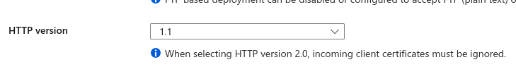

    4. Downgrading from HTTP/2 to HTTP/1.1

    Hi Wellen, we too have temporary changed our AppService from HTTP/2 back to HTTP/1.1 and the problem has gone away since.

    Currently the workaround is to disable http2 on the app. This fixes it in almost all cases.
