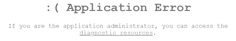

I set up a CICD pipeline to handle deploying python code to the App Service but get this screen
In the console it says "Failed to load resource: the server responded with a status of 503 (Service Unavailable)"

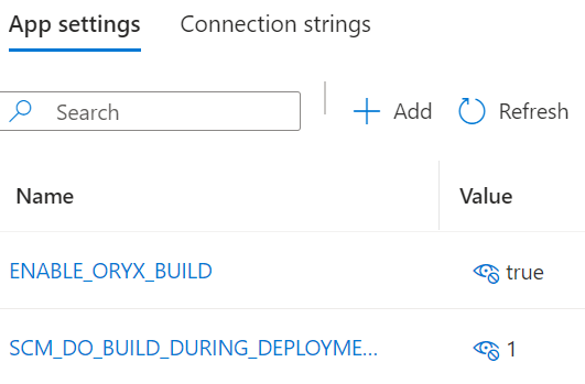

My app settings has SCM_DO_BUILD_DURING_DEPLOYMENT set to 1 as mentioned on the docs but it is still not working

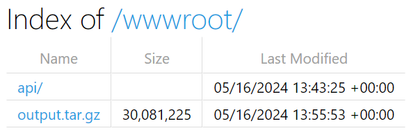

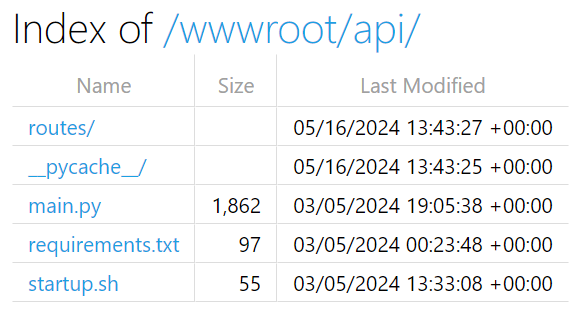

My wwwroot folder
