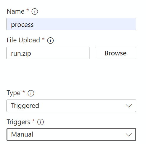

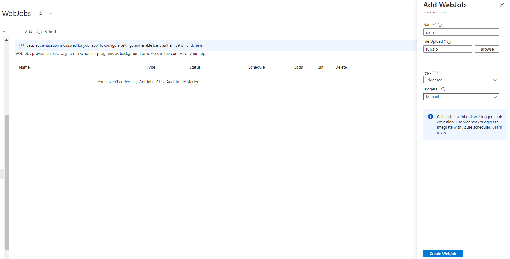

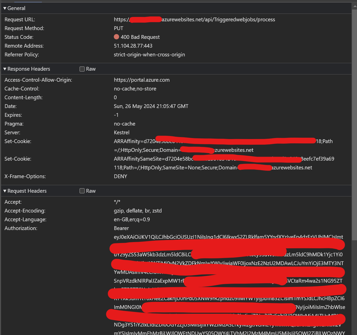

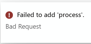

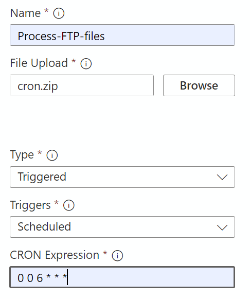

I'm trying to set up a WebJob to run a PHP script on my App Service in Azure, but when I submit the form it's returning with a "Failed to add Process-FTP-Files, Bad Request". I can see in the developer panel the response from the server is a flat out 400. There's nothing that tells me why this is a bad request; the zip file contains 4 PHP files, one of which is called run.php and the others are included by that script.

  1. Konstantinos Passadis 19,591 Reputation points MVP
    2024-05-26T19:33:31.8166667+00:00
    Hello @Phillip Parr
    Welcome to Microsoft QnA!
    Please verify :
    1. Zip File: Ensure all PHP files (including run.php and its dependencies) are at the root level of the ZIP archive, not within a subfolder.
    2. run.php: Azure WebJobs look for a file named run.{extension} (in your case, run.php) as the entry point. Make sure it's correctly named and present.
    3. Case Sensitivity: File names are case-sensitive. Double-check that run.php is lowercase.
    4. Hidden Files: Avoid including hidden files (e.g., .DS_Store) in the ZIP.

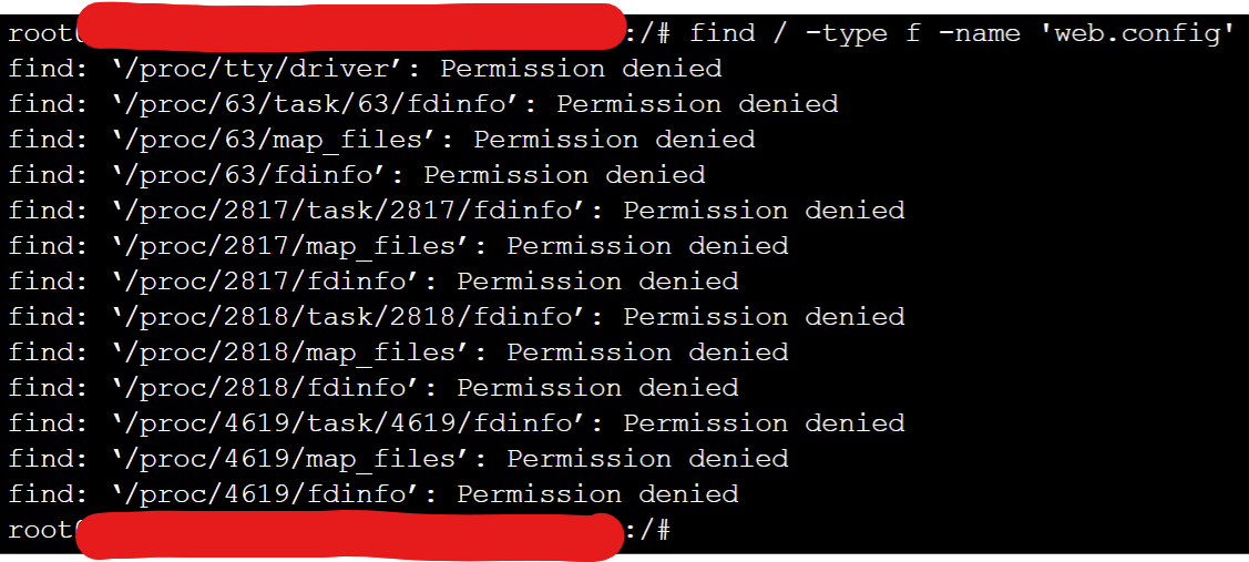

    Can we see the web.config ?

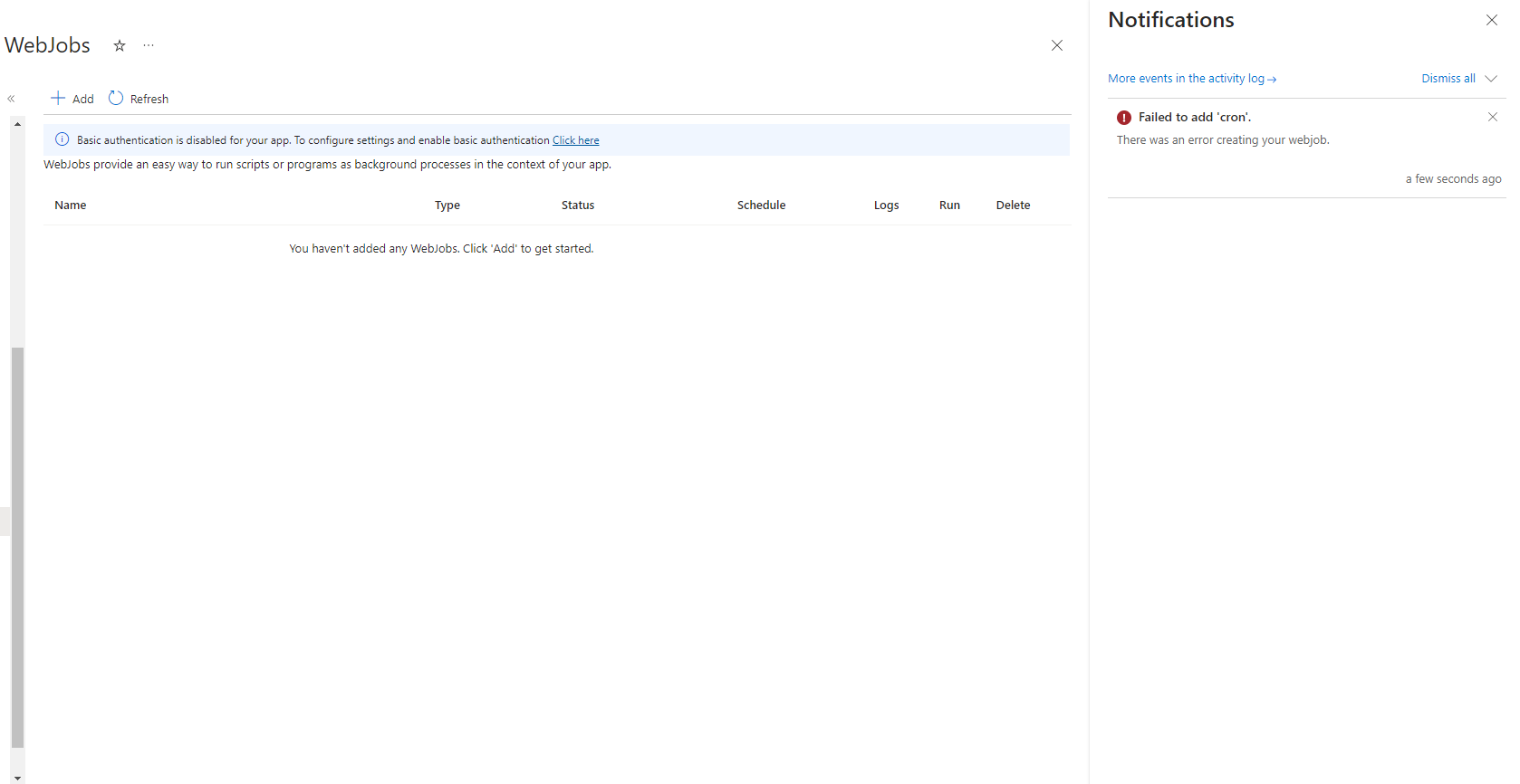

  2. Mark Jensen 25 Reputation points
    2024-06-24T17:28:13.5866667+00:00
    Same issue until i created a storage blob and connected a path from the configuration menu.
    At this point i migrated from Bad Request to "Failed to add '<name of webjob' - There was an error creating your webjob."

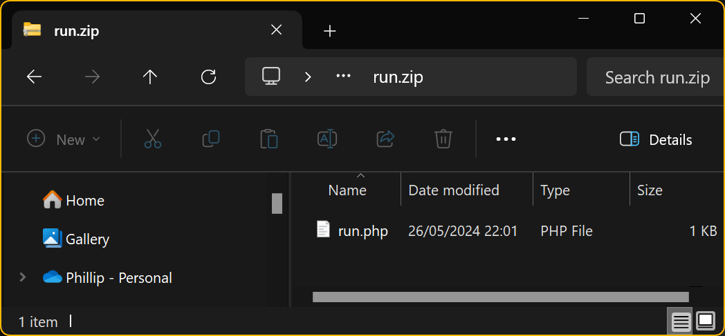

  3. Rafael Pinheiro Farias 0 Reputation points
    2024-10-22T12:10:06.9566667+00:00

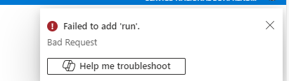

    same problem here. i am trying to debug it. I create file called run.php and just add phpinfo() zip as run.zip and upload it
    but after upload it got error
    <?php
    phpinfo();
