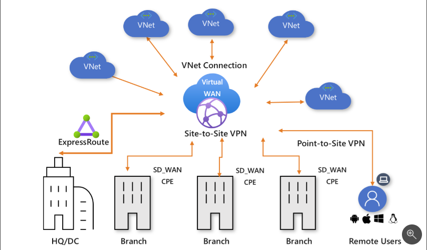

    Depending on your requirement for scalability, I think exploring Azure WAN will be helpful. The Virtual WAN architecture is a hub and spoke architecture with scale and performance built in for branches. You can also deploy a secured WAN hub for applying necessary firewall rules.
