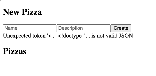

Hi!
I am working through this Exercise: https://learn.microsoft.com/en-us/training/modules/build-web-api-minimal-spa/5-exercise-create-api. After starting the Mock Server (I can see in the Browser that it is running) The Website has the error: Unexpected token '<', "<!doctype "... is not valid JSON
As far as I can see I have copied the source code to the right files in my project. Has someone an idea what is wrong or how I can debug this?
Thank you very much and have a nice day
Frank

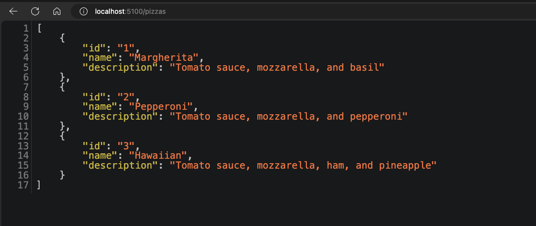

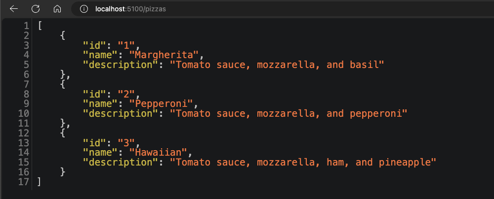

    1.Ensure Mock Server is Running Correctly
    First, make sure your mock server is up and running. You should be able to access “http://localhost:5100/pizzas” in your browser and see the mock data:
      { "id": 1, "name": "Margherita", "description": "Tomato sauce, mozzarella, and basil" },
      { "id": 2, "name": "Pepperoni", "description": "Tomato sauce, mozzarella, and pepperoni" },
      { "id": 3, "name": "Hawaiian", "description": "Tomato sauce, mozzarella, ham, and pineapple" }

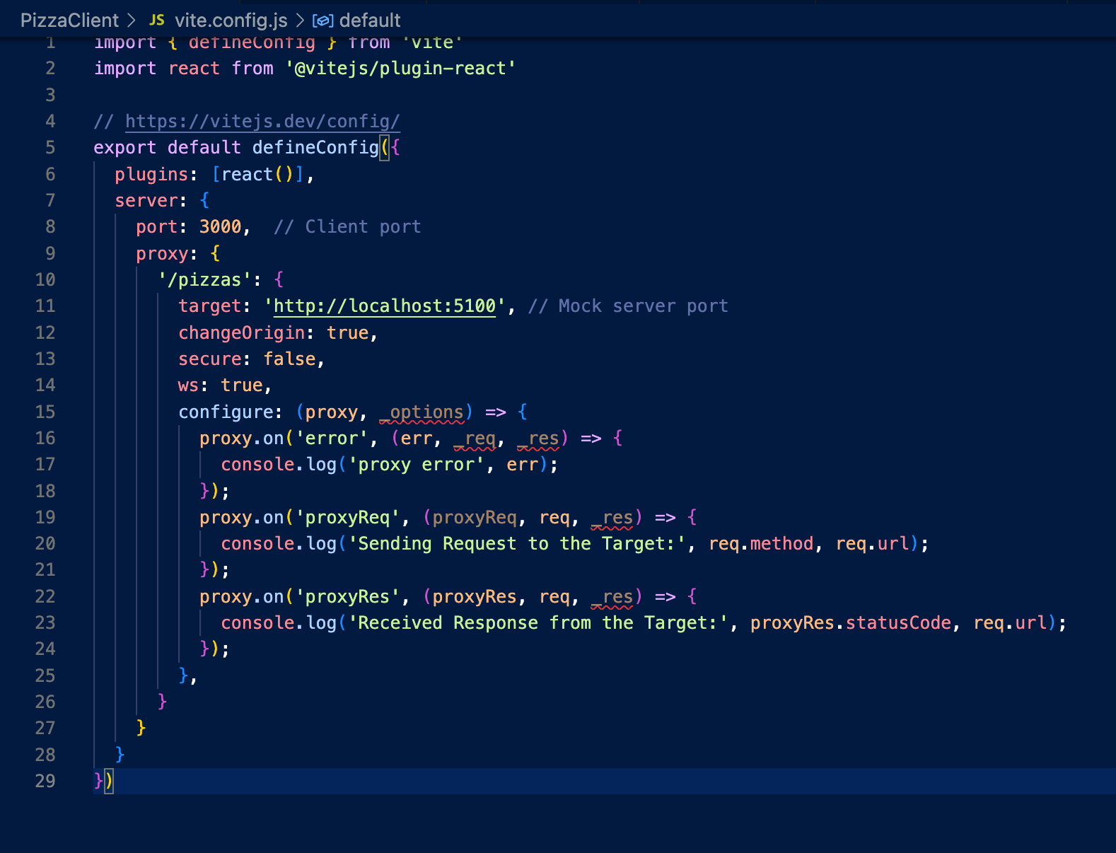

    2.Verify Vite Proxy Configuration
    Open your “vite.config.js” file and ensure it looks like this:
    import { defineConfig } from 'vite';
    import react from '@vitejs/plugin-react';
    export default defineConfig({
      plugins: [react()],
      server: {
        port: 3000, // Client port
        proxy: {
          '/pizzas': {
            target: 'http://localhost:5100', // Mock server port
            changeOrigin: true,
            secure: false,
            ws: true,
            configure: (proxy, _options) => {
              proxy.on('error', (err, _req, _res) => {
                console.log('proxy error', err);
              proxy.on('proxyReq', (proxyReq, req, _res) => {
                console.log('Sending Request to the Target:', req.method, req.url);
              proxy.on('proxyRes', (proxyRes, req, _res) => {
                console.log('Received Response from the Target:', proxyRes.statusCode, req.url);

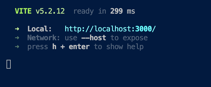

  3. Tabea Kirchner 0 Reputation points
    2025-03-01T08:29:15.54+00:00
    I encounter the same issue.
    Running the Vite dev server locally works fine (npm run dev).
    However, when starting the Dev container (in VSCode via ">Dev Containers: Reopen in Container"), the browser keeps spinning & no requests at all are sent.
