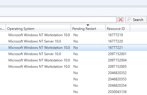

    2,A little piece of info that might help is there's a column in the console when you're looking at all devices for Pending Restart and it gives you reasons as to why the server/workstation may need a restart. As shown below:
    pending restart column
    Thanks for your time. Have a nice day!
