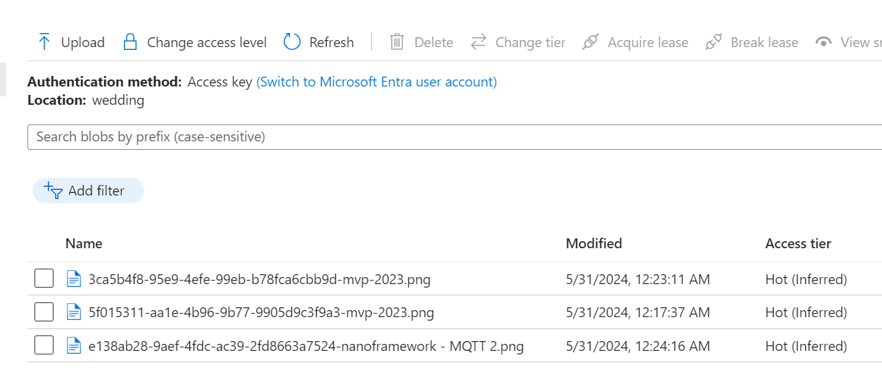

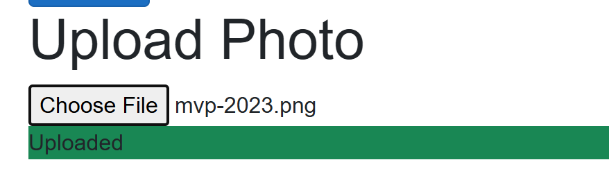

When I run this code, it works as expected:
the file is uploaded:
It seems the code on the page is not the problem.

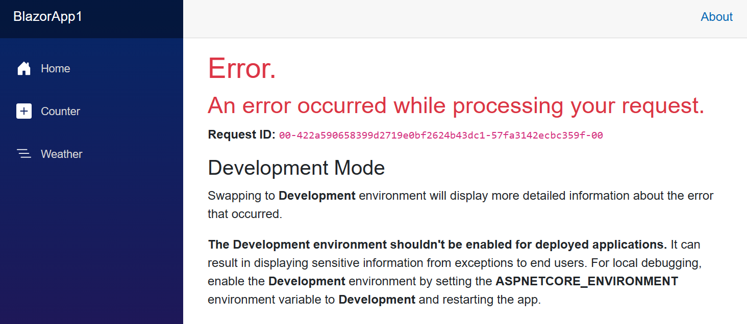

Please not your server-side Blazor app is a web application so the environment variables are read from Application settings.
Try to debug the application by setting a breakpoint both in the page and in the program.cs.
As seen in you question, internal errors (a bug in the code) are not exposed to the browser (because hackers could learn from what is going wrong internally).
