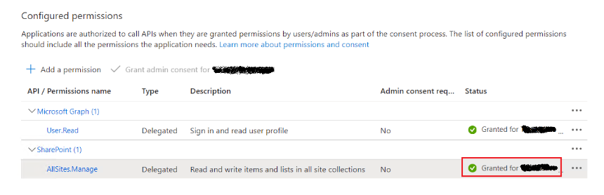

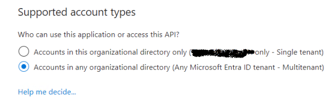

I recently registered app in Azure AD for SharePoint Online access with OAuth authentication. The account type was set to "in any organizational directory (Multitenant) " , and the API permissions are set with the scope "SharePoint - AllSites.Manage" and granted admin consent.
accounttype
permissions

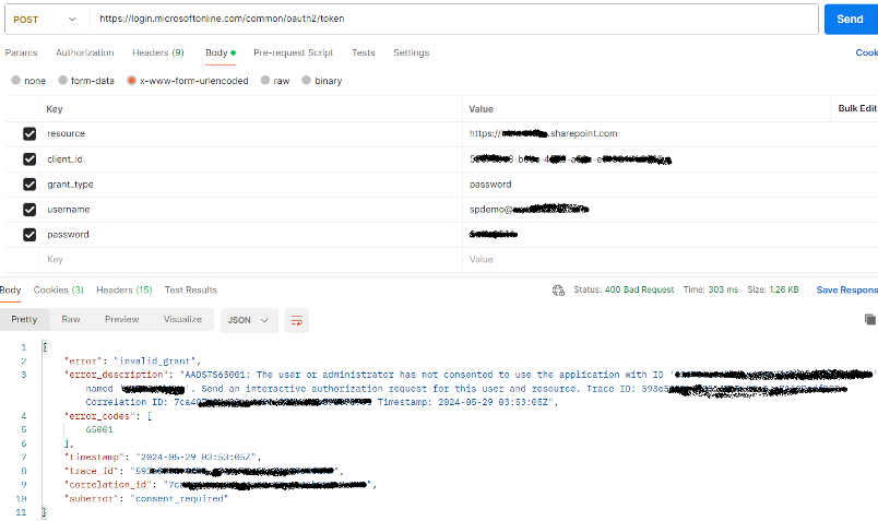

Everything is working fine with the accounts under the organization where the app was registered. Now I have a customer under another organization in Azure AD who wants to request the token with the same application ID to access their SharePoint API, but we got the error:
AADSTS65001: The user or administrator has not consented to use the application with ID 'xxxx' named 'xxxxx'. Send an interactive authorization request for this user and resource.

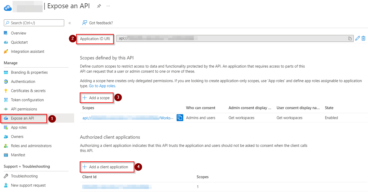

    To resolve the error, please check whether you exposed the API like below:
    Go to Azure Portal -> Azure Active Directory -> App Registrations -> Your App -> Expose an API
    enter image description here

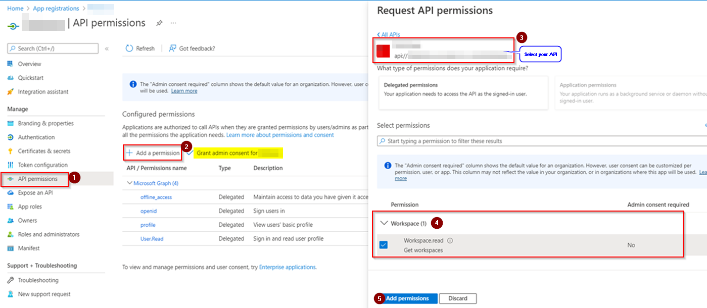

    After exposing the API, make sure to grant API permissions for it like below:
    Go to Azure Portal -> Azure Active Directory -> App Registrations -> Your App -> API permissions -> Add a permission -> My APIs -> Your API

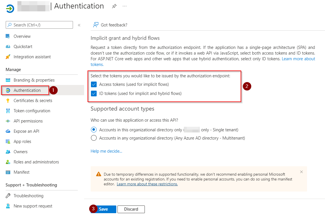

    After adding API permissions, make sure to grant admin consent if it is required. As you are trying to get access token, please check whether you enabled the below options:
    Go to Azure Portal -> Azure Active Directory -> App Registrations -> Your App -> Authentication
