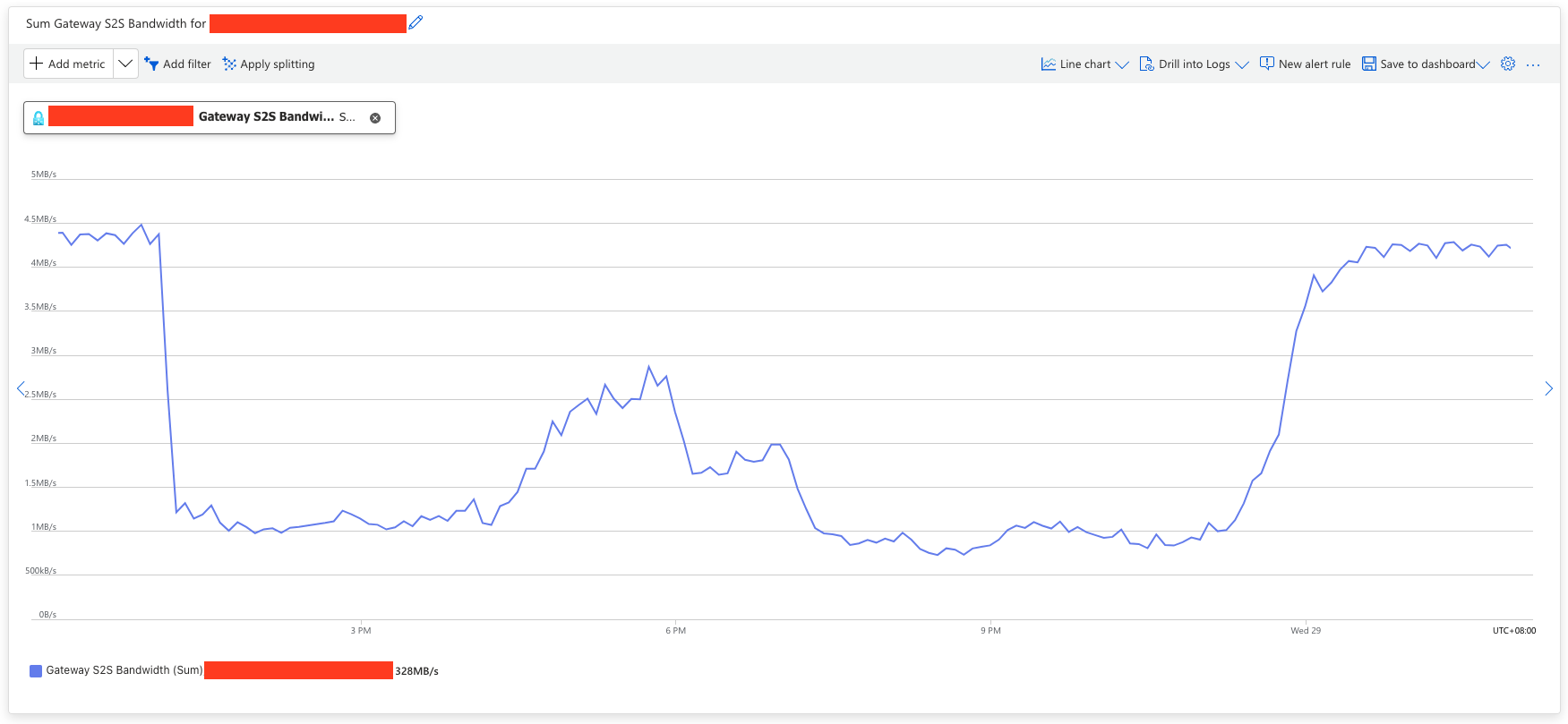

I see from the chart that although the connection was maintained, the bandwidth was dropping for more than 10 hours, as seen from the chart below.
Screenshot 2024-05-30 at 4.23.28 PM
The drop started 1pm and at 11pm began to slowly recover.
May I know if there was some maintenance / any other activity happening on 28 May?

    Looking at the Bandwidth chart you shared, I noticed a drop, but it didn't reach zero. This might simply indicate that the traffic was slightly lower during that period.
    I asked you if your customers or users reported downtime or connectivity issues during this period and you mentioned that there was no other issue with the VPN connection, but your customer reported that the traffic was unusual without much detail.
    In case you would like to validate if there was any VPN disconnection or any gateway configuration events, primary changes, and maintenance events, then I would request you to check the Azure VPN Gateway diagnostic logs for more details, if configured.
    You can check the GatewayDiagnosticLog and TunnelDiagnosticLog for 28th May during the time you noticed the VPN bandwidth drop.
