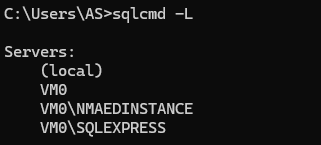

    You can use the sqlcmd -L command in CMD to list the SQL Server instances that are currently listening in the network environment.

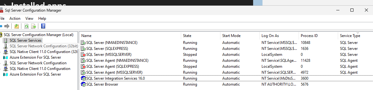

    User's image You can also view the existing installed instances through SQL Server Configuration Manager.User's image
