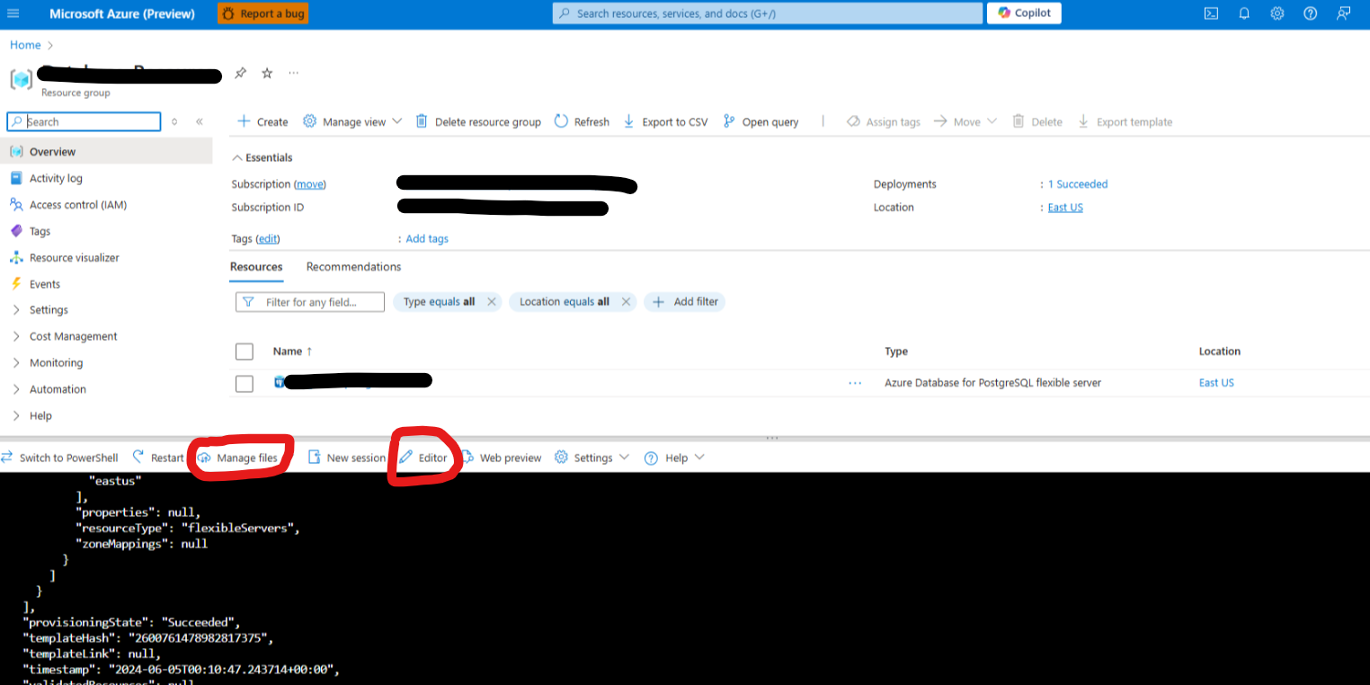

    You can save the file, then run the deployment using CLI in the Azure Portal.
    And run the deployment:
    az deployment group create --resource-group Rgname --template-file <BicepFileName> --parameters adminUsername=adminname adminPassword="password"
    Please see image below
    You need to upload the file, then Open Azure CLI to run the above code.
    Hope that clarifies.
