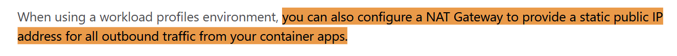

    • I see Azure Container Apps supporting NAT gateway for Workload profiles Environment type
    • And the advantage of this feature is to have a fixed, non changing "Outbound public IP" for your PaaS Service.
    • If you don't have a NAT, still you will be able to make outbound connections but you will not have control over which IP would be used.
    See : Azure Container Apps support for NAT Gateway
