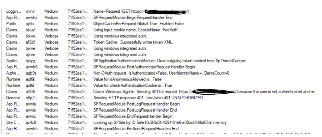

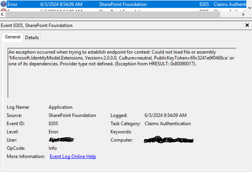

In the ULS and Event Viewer Logs, when A connection fails I am getting always this message:
"An exception occurred when trying to establish endpoint for the context: Could not load file or assembly 'Microsoft.identityModel.Extensions, Version=2.0.0.0, Culture=neutral, PublicKey Token=69c3241e6f0468ca' or one of its dependencies. Provider type not defined. (Exception from HRESULT: 0x80090017)"
But I already installed in both servers and I can find the .dll in the GAC folder and in the Program Files\reference Assemblies folder.
Also, in the ULS logs I am getting this message:
"Claims Windows Sign-In: Sending 401 for request 'https://<oneofmysites.domain.net>' because the user is not authenticated and resource requires authentication"

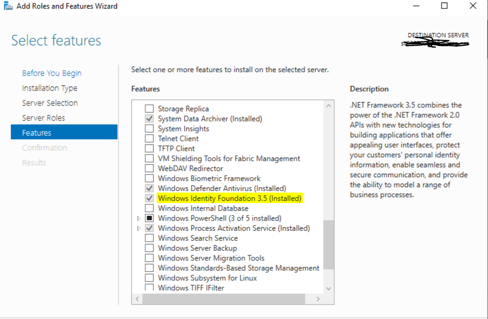

    1. Please check if you have installed Windows Identity Foundation, if not, you can install it on your project. Installed in your project: Microsoft.Identity.Model.Extensions. Once completed, restart the IIS service and see if the problem persists.

    I already have installed Microsoft.IdentityModel.Extensions in both servers:
