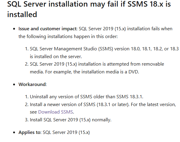

    Here is an article that fully describes how to troubleshoot it when he encountered this situation like yours, hope this can help you know more.
    if this can be detected before hand.
    In addition to what is mentioned above, if you preinstalled SSMS, you could also get the same error message you post.
