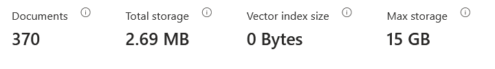

grafik
However, this did not change anything. While I could ask the bot to search my data, it was only on the basis of keywords, as no vector was provided when I ask the data manually. More importantly, the information tells me that no vector data is provided, see below:
grafik
Your help would be much appreciated.

  1. SnehaAgrawal-MSFT 22,706 Reputation points Moderator
    2024-06-06T11:38:19.18+00:00
    @Fabian Tomaschek Thanks for asking question!
    You may want to know that the "fieldMapping" property is necessary for vector embeddings.
    I suspect this requirement arises because you are using two vector fields. According to the documentation, this property is typically only required for Azure Cosmos DB/MongoDB.
    Below is the property format you may try to get the request working:
    "fieldsMapping": {
                      "vectorFields": [
                          "titleVector",
                          "contentVector"
    Refer- https://learn.microsoft.com/en-us/azure/search/vector-search-how-to-create-index?tabs=config-2023-11-01%2Crest-2023-11-01%2Cpush%2Cportal-check-index#add-a-vector-field-to-the-fields-collection
    Please let me know.
