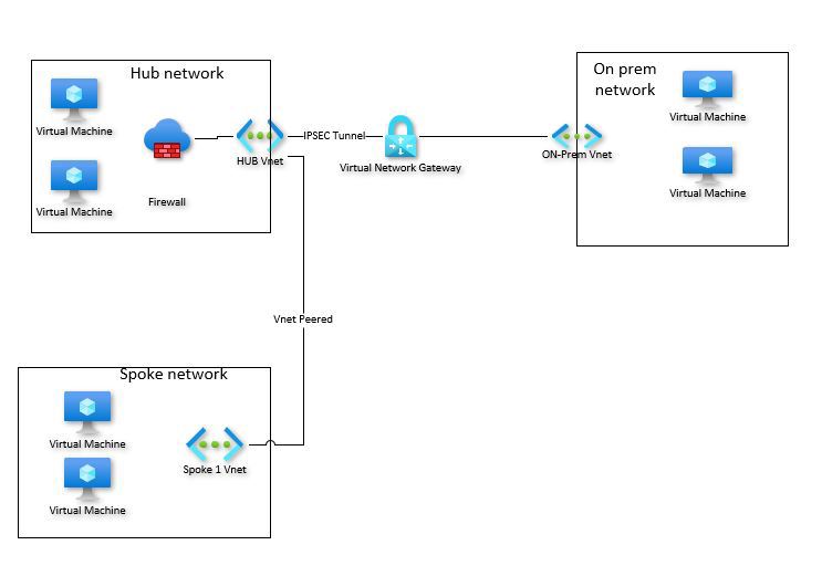

AzureDiagram
Our requirement is to preserve the source IP even when the traffic flows through the Azure firewall and then reaches the destination server. We should be able to see the source IP in the logs of the destination server instead of Azure firewalls IP as source IP.
The expectation is to preserve the source IP address.

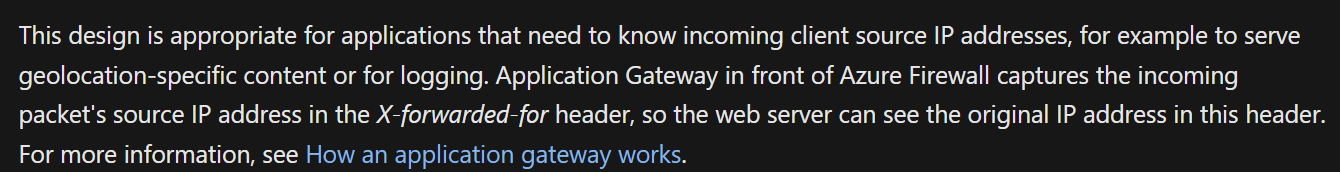

    Since DNAT happens at Layer 4, the actual source IP is not preserved by the Azure Firewall.
    This is by design.

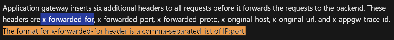

    To work around this, you can consider using Azure Application Gateway in front of the Azure Firewall and make use of the X-Fowarded-For header added by App gateway.
    Hope this clarifies.
