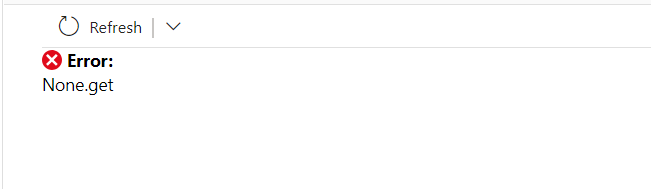

I can't do multiple unroll in flatten activity synapse dataflow
Venkatesh S 5 Reputation points
2024-06-06T16:34:28.0266667+00:00

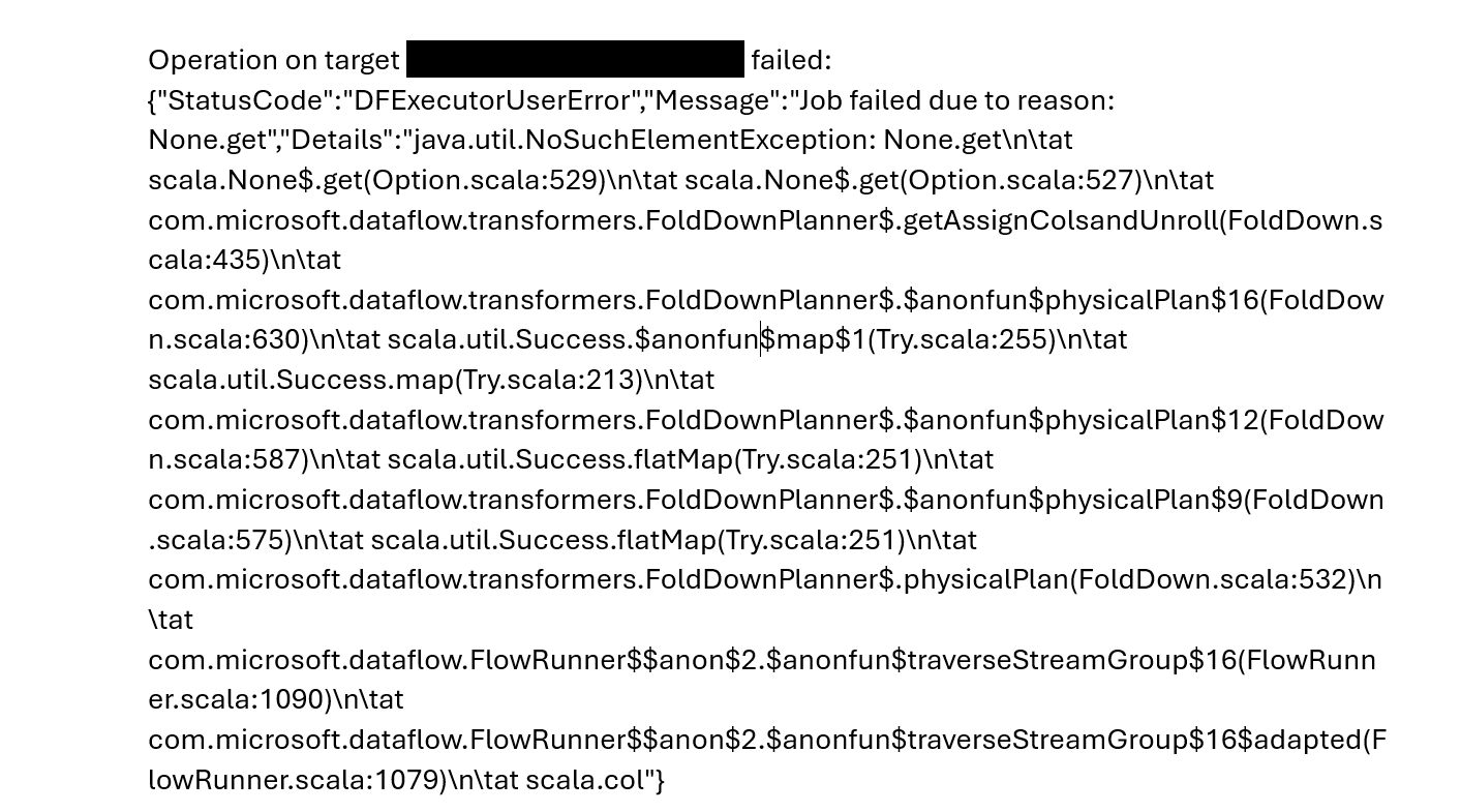

It was working quite well before, And started failing with "none.get" which is no where helping me to find the root cause, Even though I figured out that multiple flatten Unroll by cause the issue.
My source is multiple Nested JSON try to flatten them as a parquet file.
Attaching the snap for your reference

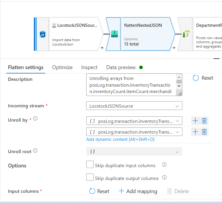

My flatten activity unroll by

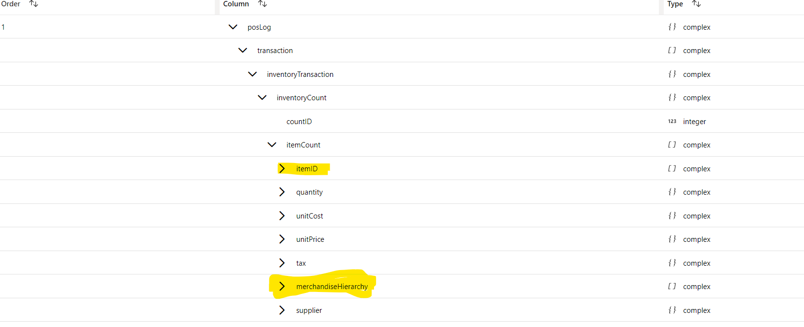

This is how my Nested JSON looks like, I'm trying to get the value out from "itemID" and "merchandise hierarchy" both are complex JSON and If i try to include merchandise hierarchy its give me NONE result which is weird.
Please help me out here. Thanks!

  3. Bhargava-MSFT 31,261 Reputation points Microsoft Employee Moderator
    2024-06-20T17:16:17.0933333+00:00
    Hello Venkatesh S
    The issue was due to a recent Spark version upgrade.
    The new version included updates to the flatten transformation logic to improve performance and functionality.
    These updates were not fully backward compatible with the previous version, leading to breaking changes.
    PG is aware of this issue and is working on a fix.
    To unblock you, could you please raise a support case so that a support engineer can assist you from the backend by reverting back the changes for your workspace.
    In case you don't have a support plan, please let me know so that I can provide a one-time free support request to work on this case.
    I am looking forward to hearing from you.
  4. José Miguel Lopez Becerra 21 Reputation points
    2024-06-26T15:21:20.32+00:00

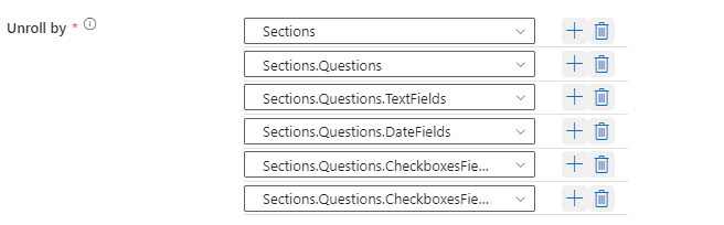

    I am having the same issue. I have my pipelines ready which include DataFlow and flatteging XML files. To do so, I had to add two "unroll by" which was working perfectly until 1 month ago. Today I find out our this issue, and after the full morning troubleshooting, I found where the problem was and came to this post.
    It is very dissapointing that suddely our code stops working just because of some Ms upgrade.
