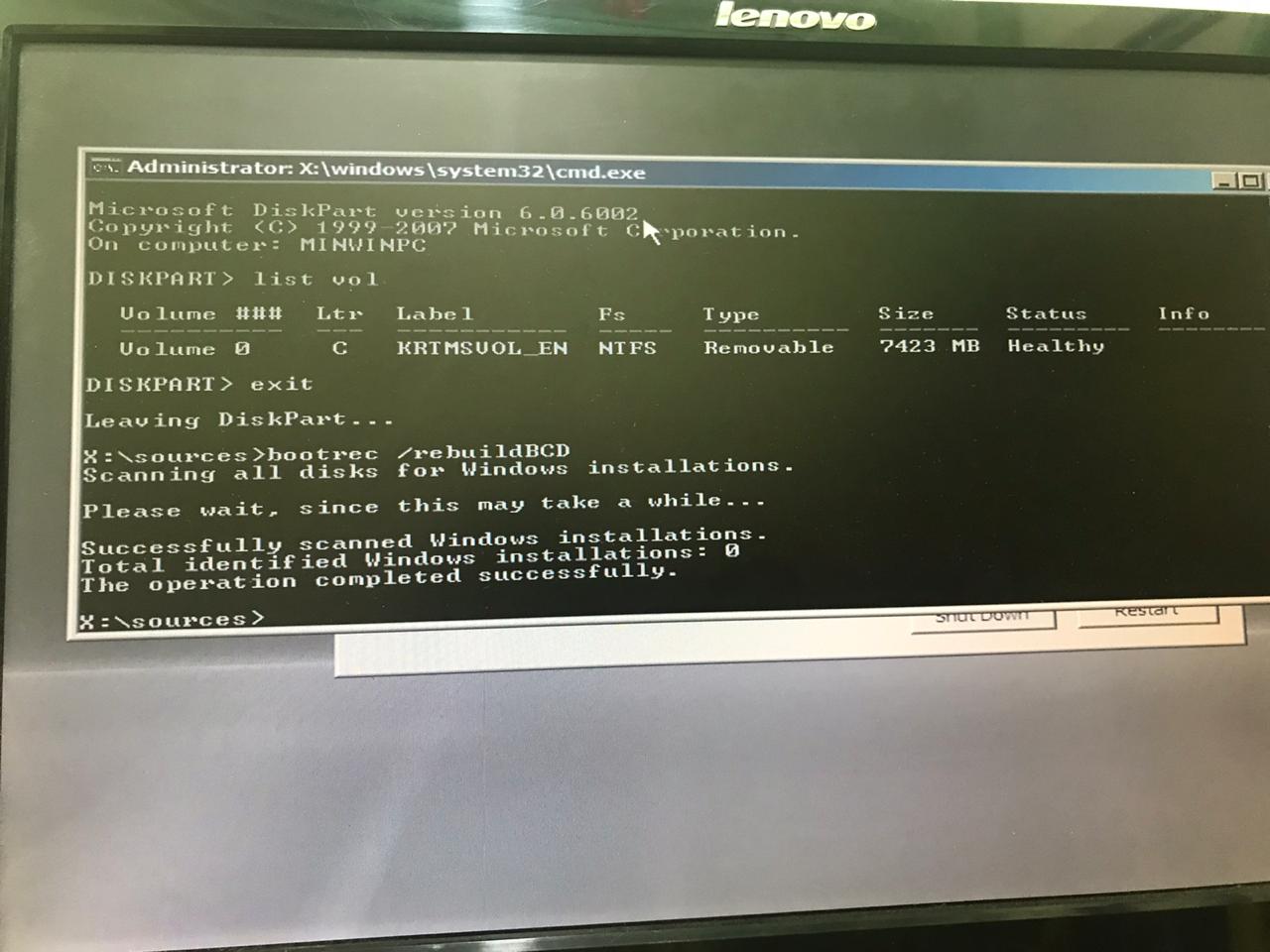

El antiguo administrador le cambio la contraseña y nunca la resguardo, el servidor es un HP Proliant el cual tiene un arreglo "HP Dynamic Smart Array B120i RAID Controller v3.54.0", al iniciar el servidor carga primeramente el entorno de iLO 4 luego arranca el Windows 2008 server.
Estoy intentando recuperar la contraseña de administrador, montando un USB con la media del Windows 2008 R2, para poder usar el cmd y renombrar el utilman para despues ocupar "net administrator" y cambiar la clave.
Al intentar localizar la unidad principal del sistema operativo instalado noto que no esta, no muestra ninguna instalación disponible, mi primer observacion es que no se cargo la controladora y por eso no puedo visualizar la unidad. No encuentro como hacer para poder cambiar la contraseña.
¿Me podrían ayudar?
Translated from Spanish to English:
The old administrator changed the password and never saved it, the server is an HP Proliant which has a "HP Dynamic Smart Array B120i RAID Controller v3.54.0" arrangement, when starting the server it first loads the iLO 4 environment then starts the Windows 2008 server.
I am trying to recover the administrator password, mounting a USB with the Windows 2008 R2 media, to be able to use the cmd and rename the utilman to later occupy "net administrator" and change the password.
When trying to locate the main unit of the installed operating system I notice that it is not there, it does not show any available installation, my first observation is that the controller did not load and that is why I cannot see the unit. I can't find how to change the password.
Could you help me?

    It is probably not related to Raid controller and I think your windows server usb stick does not have proper HDD driver. for reset windows administrator password use www.hirensbootcd.org
