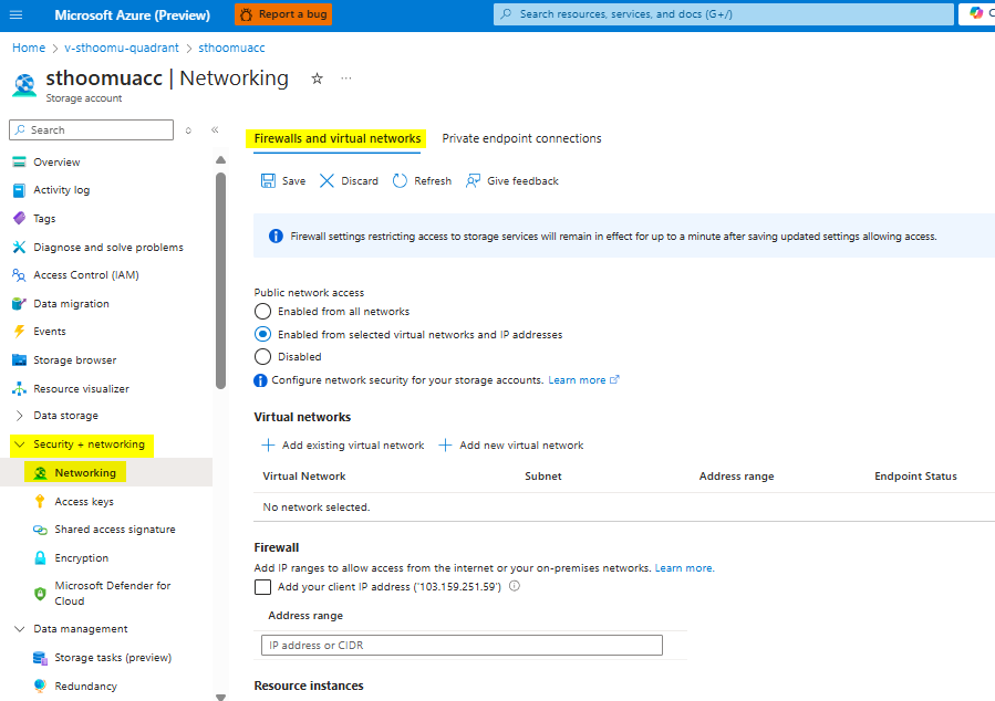

    To resolve this issue, you need to add the IP address of the self-hosted integration runtime machine to the Azure Storage firewall settings. You can do this by following these steps:
    1. Go to your Azure Storage account and select the "Security+Networking" and select the "Firewalls and virtual networks" option from the left-hand menu.
    2. Under the "Firewalls and virtual networks" section, add the IP address of the self-hosted integration runtime machine to the allowed IP addresses list.
    3. Save the changes and try running the pipeline again.
    If you are still facing issues, you can also check if the self-hosted integration runtime machine is using a proxy server. If it is, then you need to add the IP address of the proxy server to the Azure Storage firewall settings as well.
